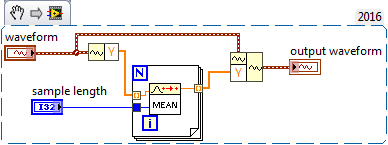

@Bob_Schor wrote:
Your formula is close to a "Box-Car Moving Averager", with 2*wl being the width of the Window (note that "wl" cannot be odd because your indices, which involve the quantity "wl/2", need to be an integer).  Your averager introduces a phase-shift, since you average more points "to the left" of the center point than you do "to the right".  You also haven't considered how you initialize and terminate this "moving average".  You might also consider the values of "i", the index of summation, when (lower-case L) is 1 ...
Bob Schor
reminds me of that point-by-point vi....
https://forums.ni.com/t5/LabVIEW/Voltage-Boxcar-Moving-Average-Filter/m-p/3659359#M1028206
(2,724 Views)
