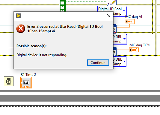

Why do I keep getting error 2 "Digital device is not responding? (VI is attached). The VI may be broken if you try to open it because of the type def.
All I am trying to do is to write to multiple channels. I want to control 8 different relays. I kept getting this error:

Hi GRCK,
check the manual of your ULx device…
Then why do you use "1chan 1sample" mode, when it comes to multiple channels???

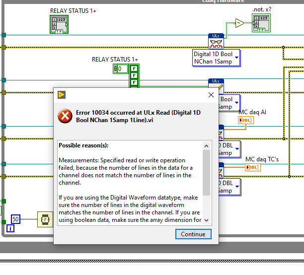

I fixed it and now I have Error 10034
Message 3 of 8
(1,606 Views)
Hi GRCK,
did you read that error message (carefully)?
Now the number of DIO lines in the task does not fit to the number of DIO lines in your array data…

Yes, I did and kept having the same problem.

@GRCK5000 wrote:
Hi santo,
I have attached the latest VI updated.
By the way I am using MCC DAQ (USB-TC-AI) hardware. I even tried to open the software for this device for configuration and kept getting the same issue.
Do you mean that even with MCC DAQ software, you get some errors? - if so, there is something wrong with the hardware itself.
General feedback - it would be best to reconsider your state machine architecture, your method of using local variables to control hardware is not best.
About the error you got, do you know which exact subVI call returned the error? in general, you seem to use 8 element boolean arrays everywhere and the DO task has 8 channels (0:7)
