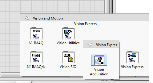

I installed the vision and motion(for my rio) library yesterday and i don't know why  the vision assistant vi is missing.
I have followed the same steps as this guy: yt vision&motion for myRio

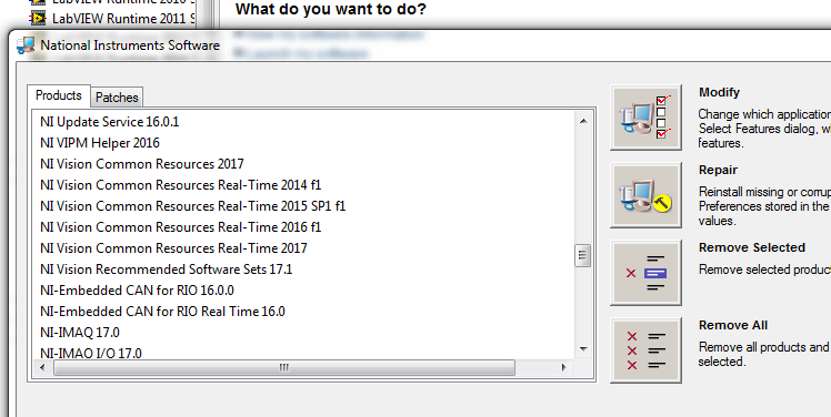

it says that vision module is installed ?! i have labview 2016labview.pnglabview.png
(5,710 Views)
Accepted by Hooovahh
No, it says Vision Common Resources. That's different. The common resources are the components shared between the driver and the Vision library.
