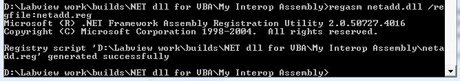

Therefore I build the following example with the including screenshots.
I used Labview 10f2 and excel 2007 as well as visual studio 2008.
First I produced quick and dirty the attached project.
After building the dll I used regasm.exe to register the dll for global usage.
As I am not familiar with the regsam things I tried step by step.
See screenshots.
regasm1 JPG (build tbl file)----> actually already in the tbl file the methodes are missing.
then regasm2 just to try if it helps and finally regasm3 to be 100% sure that it does not work.
finally I added the build *.reg entries to my registry. This also did not help to get methodes into my VBA.
