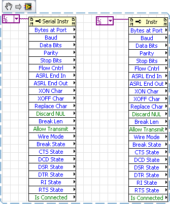

You have a few options that will control the state of the hardware handshaking lines.  The first is to use the "VISA configure serial port.vi" buried very deeply on the palettes at Instrument I/O> VISA> Advanced> Bus specific> Serial sub palette.  This vi uses a inst class VISA session and is NOT polymorphic but if you want this class of session it is the easiest method.
A second option is to use a property node to write the "Flow Control" property.  This works for any session class (and is a good way to "Peek" at the line states too!)
And a third option exists in hardware.  Simply construct a serial cable with only 3 wires RX, TX and GND at pins 2, 3, 5 or 3, 2, 5 depending on if the equipment is DTE or DCE.  Its really hard to assert a signal (like DTS) that is not connectedSmiley Wink

That does allow me to explicitly control the DTS line, but only after the VISA session is already open. After further experimentation, it appears that the problem is really with Close Session asserting DTS.
