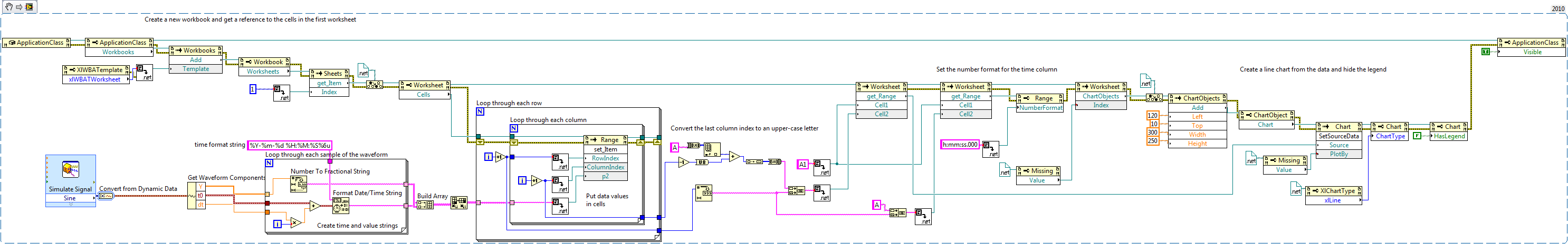

DIY ActiveX/.NET
The Report Generation Toolkit is built on top of the Excel ActiveX interface. You can use this API either through direct ActiveX calls or the Microsoft.Office.Interop.Excel .NET assembly to automatically create Excel files. The code snippet below produces essentially the same result as the Report Generation Toolkit example but instead uses a .NET interop assembly to communicate with Excel. As you can see, the code ends up a little more complex but anyone with a background in ActiveX/.NET programming should feel right at home.
[+] Enlarge Image
Here is the output of the above code snippet:
 0# you need MS Excel 2007 or higher installed on your PC
1# get that demo to work**
2# modify the demo to your needs
If this is to complex for you (as you have said several times),
than maybe you should ask yourself, if this is the right task for a beginner.
** I had to manually re-select Microsoft.Office.Interop.Excel(15.0.0.0)>ApplicationClass()
see attached
