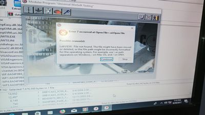

I am new and lack of labview .
But I am a chief of the lab. (Mechanical engineering). We have problem with our Universal Tensil Machine or UTM. The computer or software has no connection with the UTM installation.
Please help us. I am sorry for my English.

It is difficult to understand what is happening. I guess that this program was made by WinSoft (https://www.winsoft.com/). Have you contacted them?

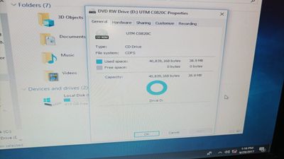

Try to extract (unpack) all of the files to disk first. Then open the exe from that location.
I guess that you have tried to open the program directly from the unzip tool and there are files missing.
Please understand that this is only a guess. Your program was made by another compaby - I guess "WinSoft". I am sure that this company can help much quicker and knows what is going on here.
