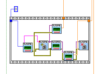

This is a screenshot of the sequence structure, which first starts with a node to get the device resource string. This device resource string is then fed into a node that initializes the device. The instrument handle from that is then passed onto two nodes that get the temperature and humidity data, and after that there is a node to stop the driver session. This sequence executes about once every second. I do not know what is causing this issue and thus any advice or fixes would be helpful as we try to take around 100hr runs, and that cannot be done if the temperature probe crashes.

I cannot look at your VI, do not have the latest version on this computer. If you want more people to help, save it it in version 2020.
Typically you do not reinitialize and stop the driver in the loop. This is bad advice. Initialize the driver outside your loop, close it when your loop finishes. If you have an error in the loop, then you can always close it and reinitialize it.
Your sequence structure does nothing; it isolates the Thorlabs code but does not do anything else. Think data flow. One potential issue I see your code is that you are trying to do things in parallel; typically this can be problematic. Connect your VIs by their error out error in so they operate in a sequence.
  1. Initialize (Outside Loop)
  2. Measure Temp
  3. Measure Humidity
  4. Close (Outside Loop)
Steps 2-4 should be in sequence, do not try to measure in parallel, do not think your sensor can support that.

@DiptoP wrote:
I will try putting them in parallel.
NO!!, Put them in serial order. In your picture you have a wire branch and two VIs can operate in parallel. You do NOT want this, operate them serially.
The error in/error out, besides providing error information, can enforce execution order, that is, data flow. A VI can not operate until all its inputs are received.
