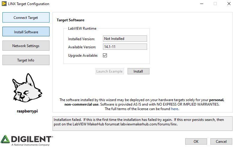

With the release of community edition I have been very excited to implement my personal projects onto the latest version of the pi, 4b. However I am having difficulty. After searching the web and reading plenty of forum posts on makerhub, I am still not able to use Labview via linx toolkit on my pi. During target configuration my development pc connects to the pi with ease, however every time I try to install the software I get an error has anyone else faced this problem and know of a solution? Thanks in advance!

"If this error persists search, then post on the LabVIEW MakerHub forumsat labviewmakerhub.com/forums/linx"
Not sure what "If this error persists search" means, but "labviewmakerhub.com/forums/linx" seems to be the place to post this problem if you don't want to wait.

I think you have to jump through all kinds of hoops if you installed the OS using the NOOB option.  (Does that still exist?)  I think it's because it creates two partitions that can roughly be equated to an OS partition and a data partition.  LINX (at least as of LINX 3.0) tries to install to the first partition and can't find enough room.  I think the fix involved deleting the big partition and stretching the first partition to cover the whole disk.  I don't remember.  I think it's been discussed to death in the MakerHub forums.
