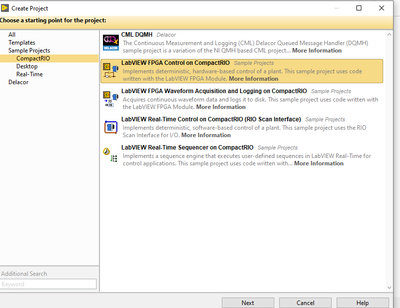

You should really develop your user interface to be deployed on a PC, this user interface then needs to communicate with your CRio using network streams, tcp or udp communication.
Have a look at this sample project to get more of an idea.
