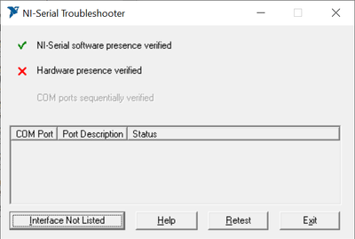

I used the NI-Serial Troubleshooter and the result is shown below.
Used Interface not listed and in the part describing the installation basically boils down to 4 points

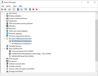

In Device Manager one can choose to display hidden devices:

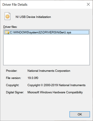

I guess the problem is the version of the NI-Serial. I had the 19.0 installed which is not compatible with the 485. On the other PC I have version 15.0 and it works fine.
The NI-Serial 17.5 installation did nothing.
