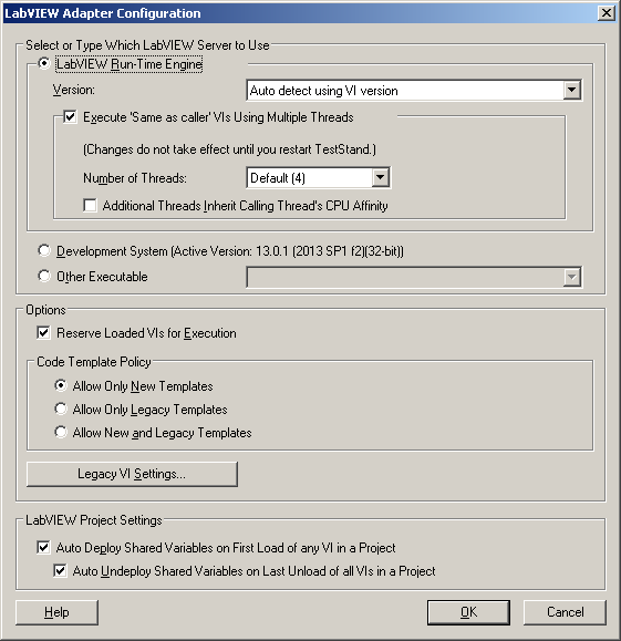

I'm not having any success reproducing the issue.  Here is my adapter configuration:

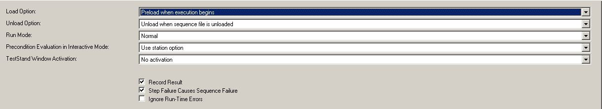

Here is my step settings when I call my VI:

Nevermind, I am able to reproduce this, I didn't read your description closely enough.  When I close TestStand after executing a sequence that uses VirtualBench it does crash.  If I configure the LabVIEW Adapter to use the Development System it does not do this.  I am looking into it now.

Similar to you, I don't get the error if I have the Adapter in Development mode and I execute the sequence from TestStand.
But I have a Labview user interface that calls the TestStand sequence. This User Interface I have it as an executable and as a Labview VI. When I run it as a VI I set the Adapter to Development. and the error also happens.
