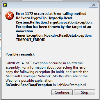

I am using the Rotronic  HC2-ic102 probe. The correct driver for the probe is installed and the probe works on another computer system using the same Labview code. When I use the HC2 probe on my computer system i get the following error,
Could it be that the computer system I am using has two seperate drives a C: Drive and a 😧 Drive. Labview 2012 is installed on the 😧 Drive. I have tried running the Labview code on both drives but I still get the same error. The labview code is a single Vi saved in a folder with the DLL supplied by rotronic. Does anyone have an ideas why I am getting this error?

The error description says 'TIMEOUT_ERROR' - which is the error thrown by the .NET library - it sounds like the library is not receiving a response from the device so it is timing out. How is it connected? Is it on a different port (e.g. COM2 instead of COM1 if it's serial)? How is the port specified?

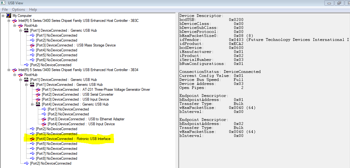

The probe is connected through a USB port, Here is a screenshot of the Rotronic USB port connection.
The port is specified as a USB port located at Port 4.

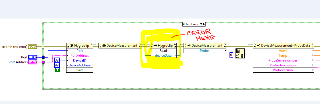

Can you show us your code?

The screenshot you posted was too small to view the text.
The error occurs at 'readdata' because that's probably the first time the code actually tries to communicate with the device and it gets no response.
One of the configuration settings (e.g. port, port address, device address etc.) is wrong.

Here is the screenshot of the port again,

According to the screenshot, you have at least 4 "Port 4"s according to that USB View software so "Port 4" isn't enough information to uniquely describe the 'location' of the device.

Which port and port adress are you specifying in your VI?
Also, why is there a coercion dot for the wire into your first Invoke Node?
