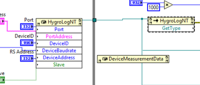

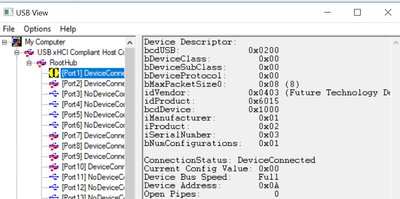

I contacted rotronic and they told me to install the driver "USB_Driver_FTDI"
I installed the driver and started the device like this:
