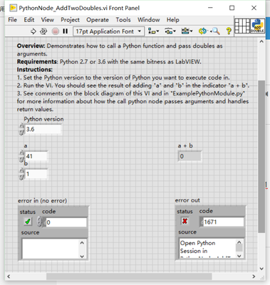

Hi, I run the demo of labview2018, "PythonNode_AddTwoDoubles",
The example returns an error code"1671".QQ图片20181023151217.pngQQ图片20181023151217.png
labview2018, 64bit
python 3.6.5, 64bit
computer win10
Can anyone help me with this problem? Thanks!

It dosen't solve my problem.
My python code was on local storage originally.
And I run the demo of LV2018, the same error code 1671

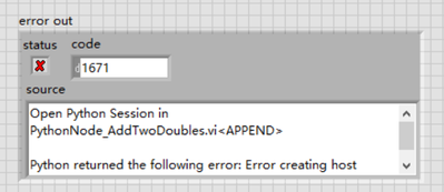

---> Open Python Session in TestPyhonNode.vi<APPEND>
Python returned the following error: Error creating host process (Code 1671)

This does not help. It is already the "Open Python Session"-VI what is crashing.
Win10+Python 3.6 (32bit) + LV2018 (32bit), the path is set
