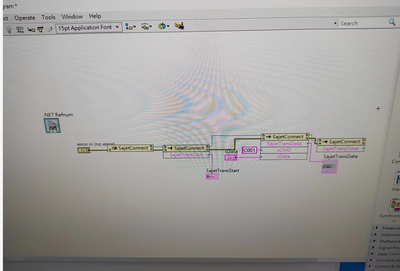

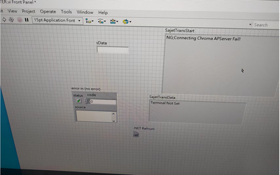

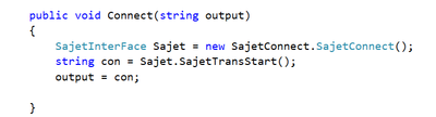

Hi, All
   I faced a trouble, normally the .dll library can connect the database through C# program, but I invoke the .dll library can't
connect this database , I don't know why ,I used the method is the same with C#, please refer photo and .dll file,thanks
lavview connecting fail
C# connect successful

what's the reason? why labview to invoke the sajetconnect.dll file is failed,but C# use the same method is successful ?thanks a lot

Thanks ,Resolved
Message 6 of 8
(2,264 Views)
Please tell us what you did to resolve this.
Rolf Kalbermatter  My Blog
Message 7 of 8
(2,253 Views)
as you reminder, need to create the .exe file to run and then connected the server,thanks
