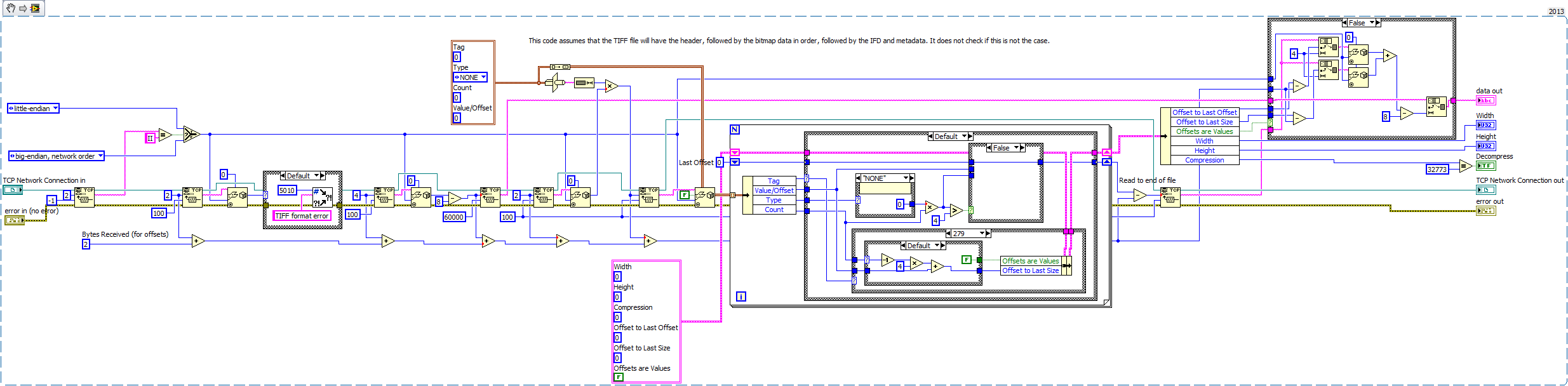

On the off chance it's helpful, here's some pure LabVIEW code I wrote that reads a simple TIFF image. In this case, the same program always generated the TIFFs, so it's a bit specific to that output, but it covers the basics of TIFF parsing. Also, it reads a TIFF image arriving by TCP, but you should be able to directly replace all the TCP Reads with Read from Binary File. You'll get the bitmap data (without all the metadata) as a string, which you can unflatten to an array of the appropriate numeric type (if it's a black-and-white image you'll need to split the bytes into bits as well).
Take a look and see if you can use it. This is in LabVIEW 2013 but I can save it back to an earlier version if needed.
Message 50 of 115
