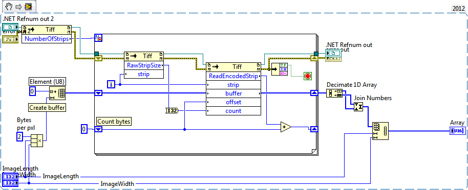

Thank you so much, stran.
Since I have LabVIEW 2011, I cannot open it though. I recreated the code using your attached blockdiagram image. It works, but I noticed that it executes slow taking 54 seconds to load a 2560x2160 TIFF file.

This won't solve the whole performance problem, but try "swap bytes" instead of decimating and joining. It's probably faster and more efficient.
Message 55 of 115
(5,004 Views)
Thanks, Nathand. Swapping bytes reduces execution time from 54 to 53s, and the image is corrupted (looking similar to a solarized image). The bottleneck is the ReadEncodedStrip node, which requires 18ms to execute for each of the 2560 strips. Decimating and joining the array adds 253ms to the total execution time, so is negligible in comparison.
Oops! Sorry, yes. That was sloppy of me, didn't look carefully enough at what's happening. You would need to Type Cast the array of U8 to an array of U16, then swap bytes... but at that point, it would be better to convert the array of U8 to a string (this is essentially free, shouldn't require reallocating memory), then unflatten from string into an array of U16 with the endianness set properly. Not sure if that would be any faster, but it's easy to try.
I'm curious if a pure LabVIEW solution like the one I posted earlier is any faster, but I don't have time to investigate right now; maybe this evening. I don't know how efficient LabVIEW is at handing large data structures back and forth to .NET code.

Hello again, Nathand.
I tried flattening the U8 array to string and unflatten to U16 array, but this produced:
Error 116 occurred at Unflatten From String in Read Tiff File (Bitmiracle libtiff.net) Fixed.viPossible reason(s):
LabVIEW:  Unflatten or byte stream read operation failed due to corrupt, unexpected, or truncated data.
Typecasting the U8 array to string and unflattening to U16 array produced the same result. As I said, the conversion is currently not the bottleneck.
Sorry I was unable to open your earlier code since I need it in LV2011. When I looked at your block diagram picture I decided to continued pursuing the .Net solution first. But now, if you send me the code in LV2011, I am ready to give it a try and convert it.
Peter
I'll try to do that later this evening; I don't have access to LabVIEW 2013 to do the conversion right now but I will later.

Yep. The "data contains array or string size?" input was still TRUE. The error went away, but the image still looks corrupted. I will wait until you find time to convert your VI. Thank you so much.
Peter
