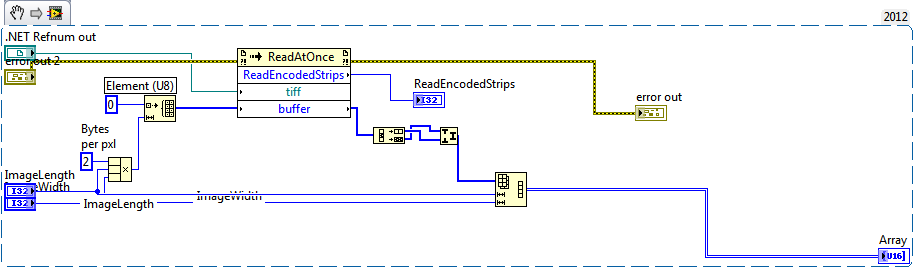

  • Read Tiff File (bitmiracle libtiff.net).vi: I can load and display my Tiff file. The total load time for the dropbox image including decimating the 1D array and joining numbers is a little over 400 ms. This is a already big improvement, but still a factor of three slower than the 32 bit libtiff library.

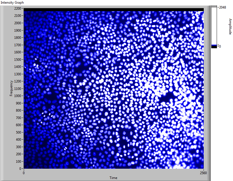

I used as a test image for my code, the image you uploaded. It didn't occur to me to use an intensity graph for display though, as the code you uploaded does. When I drop an intensity graph on the front panel of my VI, and connect the image data to it, I get the image below. Just out of curiosity, is it correct (if perhaps rotated or upside down)? If so, my code does what you need. The code you posted is more comprehensive, although rather dated in the way it's written.

Glad you got it working. My image is grayscale, and it is rotated 90degrees counterclockwise compared to the image you posted. I paste the image in its required orientation:
I already have the rotation of the array implemented albeit slow. Did you benchmark your load time or can you send me your code, please so that I can test it here? Thank you so much.
