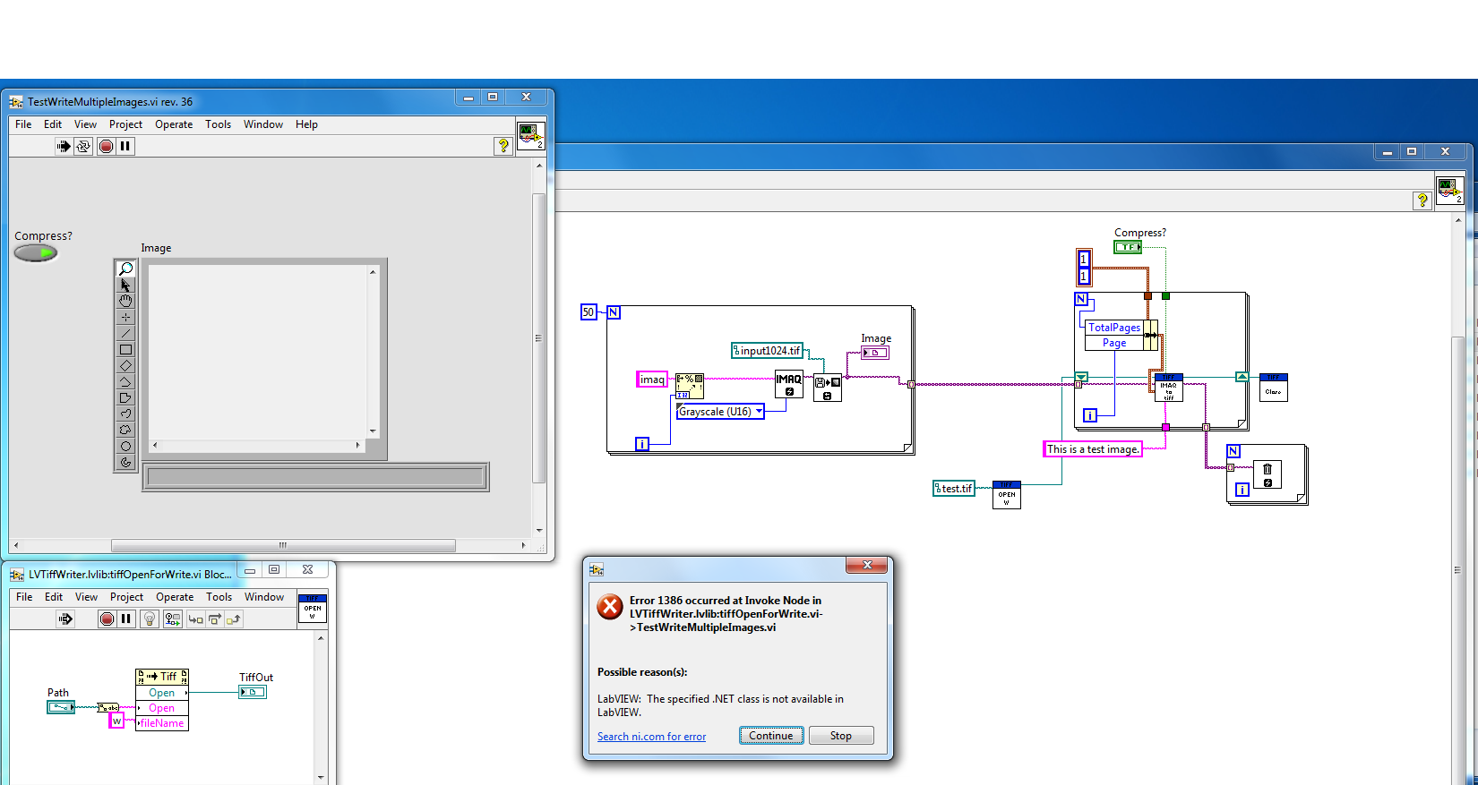

Thanks a lot for your sharing! This is just what I need for my work now. I am just trying to save single .tiff files into a stack. But I have met a problem when I tried your code and I don't know why. Can you help me with the error solving? Attached is the error message. I am using Labview 2014, 64bit.

Have you installed the right .Net component? You would most likely need the LibTiff.Net component installed on your system for LabVIEW to be able to use it.

Thanks a lot for this reply! I have downloaded the libtiff.net.dll file from http://bitmiracle.com/libtiff/, but it seems that I will need Visaul Studio to build the .net file in. But I don't have VS installed, so will there be another way to build the .net.dll file in? Thanks again for your help!
