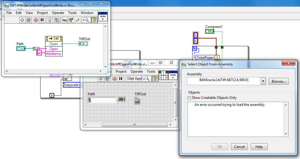

Hi, I tried to right click the Invoke Node in the LVTiffWriter.lvlib:tiffOpenForWrite.vi (shown in the attached figure), and select the the .NET class, it shows the error as shown in the figure...and I am not clear what is the error.. thanks if you have any clue about this.error.png

And why don't you go and install that .Net library on your computer?

@Shaobo183 wrote:
Thanks a lot for this reply! I have downloaded the libtiff.net.dll file from http://bitmiracle.com/libtiff/, but it seems that I will need Visaul Studio to build the .net file in. But I don't have VS installed, so will there be another way to build the .net.dll file in? Thanks again for your help!
On this page on the right side is a section with three entries it is saying Download binaries (5.9 MB) and Download binaries from NuGet and Binaries normally means the compiled end product including installers. So what doesn't work there?

Hi, thanks a lot for your patience. I have tried a lot of methods and found this may caused by the he version of my labview, it is 6-bit 2014 one, and the library seems to be a 32-bit library...

I haven't looked at the libtiff.Net library but that is a possibility. I doubt they reimplemented the entire libtiff library in C#, so likely it is in effect still C(++) code and compiled by the Visual C compiler so not achitecture independant and requires the library to be in the right bitness. If it was completely reimplemented in C# then the .Net library could be architecture independent.

Being able to run on a 64bit Labview was the reason I redid Nico's code with libtiff.NET in the first place. (Considering the relative performance loss I maybe should have spent my energy on compiling libtiff for 64bit Windows, though.)
Unfortunately, I do not have any ideas not already mentionned above. If I remove the libtiff.Net dll and try to run the tiffOpen.vi I get a different error message (Error 1081376032 occurred at Invoke Node in LVTiffWriter.lvlib:tiffOpenForWrite.vi)
I suppose you already tried relinking the Invoke node by right-click -> SelectClass -> .NET -> Browse... -> Browse... again -> select the .dll ? The libtiff.NET.xml might also be need. I think it might be something like a header file.

Since it might not be uncommon to have a 64bit Matlab installed alongside the 64bit Labview I just noticed that Matlab has a
libtiff.dll compiled for 64bit in their bin\win64 directory which might work with Nico's code.
