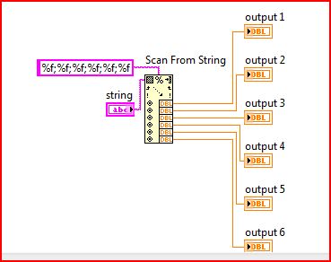

if you're always sure that there are six elements in the array, you could use index array. Alternatively, instead of using the above function, use scan from string.

Actually, I think I know the answer to that. An Index array block does that. Thanks again!
