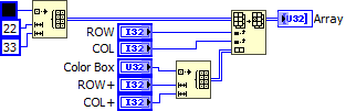

Here's very simple example how you can replace rows and/or columns with different colors. To make the change persistent, keep the array in a shift register (not shown).
(using a flat colorbox for better cosmetics)

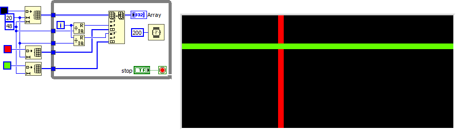

thank you very much for help and hints i made edit to change what i need from rows to columns numbers but i can't retain the value because of the control rechange it again please use the lamp to see how it works correctly .. how to get around this.

(Please use a new name when attaching a new and different VI. Re-using the same file name causes confusion and if subVIs are involved, can lead to incorrect dependencies if an old subVI with the same name already exists. The new one will be renamed by the browser to "subVI(1).vi" and the old one called instead).
Anyway, shift registers are your friend and a core skill in LabVIEW. Learn all about them!
(Of course you could use initialize the differently colored subset and use "replace array subset" instead. No loops (or shift registers) needed. Not shown)
Here's how that could look like. same result, arguably simpler! 😄
