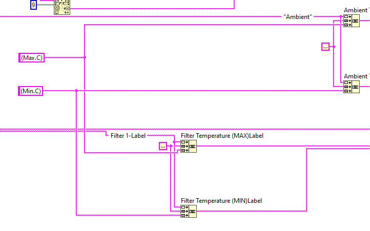

A project I am working on, starts with a .csv (like) file that I think needs to be indexed, re-sort the items, and create a three line output (with comma delimited) between them. The headers (line 2) and data (line 3). The index array works but the code is cumbersome to troubleshoot. There must be a better way to index values and create the text file; but I am not sure how it can be different.

Holy cow, you weren't kidding. This block diagram is enormous... troubleshooting would be nearly impossible!
Without knowing your input file format and output file format it's hard to give you any real advice, other than "Index array" should probably only be on your diagram once.
If your format is based on row/column positions, then I'd probably create a struct typedef containing a row, column, and label. The label will be for easier handling, but you might not need it.
Put this into an array, then into a For loop indexing on this struct. Within the loop, do your Index Array and build up your "Output" array, which you can further manipulate or just concatenate.
You will need some way to store the "decoding" information. If it's rows and columns, use an array of rows and columns. If it's got labels (like "FilterID: [value]" then you can use string searching functions to just parse through the string to find the "identifier" then extract the next value.

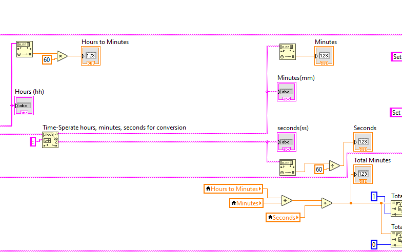

I would then guess since its so large that the array isn't processing the time to minutes correctly due to its size also?
No, that would probably be a race condition you have from using local variables. You are writing to "Hours to Minutes", "Minutes", and "Seconds" each iteration of the loop but also using local variables to read the same data. Which one will happen first is anyone's guess. The local variables could very well still have the data from the last loop iteration before the controls are updated (or whatever data is in the control on your first run). The wires are literally just a few inches from the variables, just use those instead!

Here's an example of what Bert was suggesting. There is a for loop that can handle all the index arrays and concatenate functions. (I did the first line of your new output as an example.)
There is also some Rube Goldbergian code in there that could be cleaned up as well.

You should also check out the "Format Into String" function instead of using "Build String" with 4-5 inputs.
For example, if you have a a wire with the string "20" in it and you wanted to make that say "Max temp: 20 (C)", you could do that with a Format Into String with the Format being "Max temp: 20 (%s)", and it'll wire your string "20" into the spot it sees the "%s".

Instead of those gigantic Concatenate strings to create the comma separated row, create an array of the string and use a Format into Spreadsheet string with comma as separator. It'll more than half the needed wires (and thus the clutter).
Also, Sub-VIs are important!

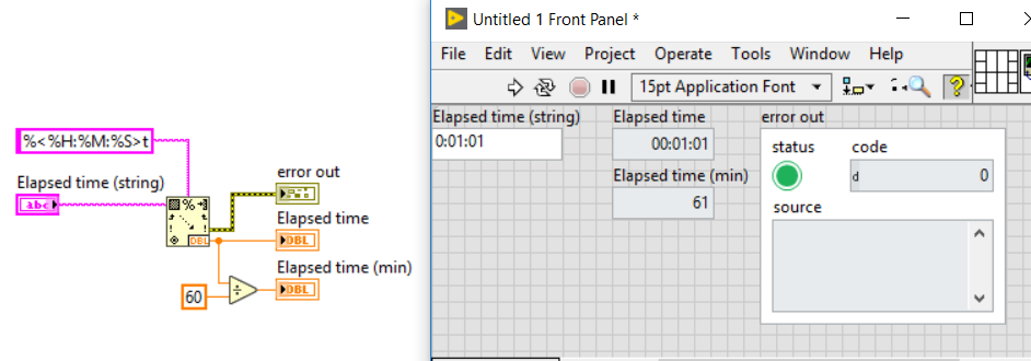

E.g. instead of all that string manipulation to get the Elapsed time, you can do it like this:
