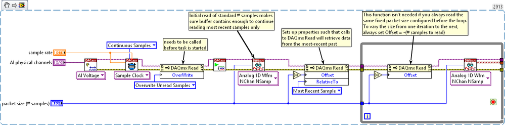

Why in the world would you want to do a sliding average over 1/2 cycle?!?   You're just gonna get a sine wave of reduced amplitude.
If you want to update your average at a rate equal to 1/2 cycle worth of time, that's a subtly different problem that can be solved other ways.  Example: a moving average that accounts for, say, 6 full cycles but which you "slide along" to produce a moving average every ~8 msec.
There's also a DAQmx technique that lets you retrieve your data in a non-contiguous way.  Then you can request 6 cycles worth of data every 8 msec and do a simple average, knowing that consecutive averages will be based on data with 5.5 cycles worth of overlap.  Here's how you do it (extracted from one of my old posts😞
-Kevin P

Hi Kevin
Exactly this is what i want to achive, an updated  average at a rate equal to 1/2 cycle worth of time. In other words i want 2 power measurements into 1 cycle of 60Hz.
That is why a moving average that accounts for, say, 6 full cycles but which you "slide along" to produce a moving average every ~8 msec seems to me a good idea.
I am not sure how to implement this into my consumer loop, since the power block in labview need at least 1 cycle to have an accurate measure.
(2,383 Views)
