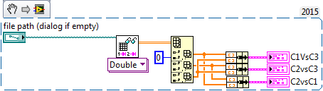

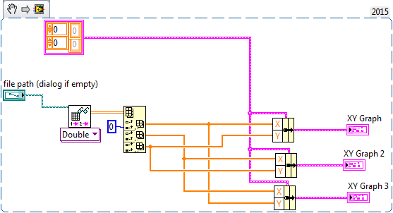

Great option! I chose the "read spreadsheet" and eliminated my previous vi to get this as shown on the snipped photo.
Now, as you can see I have 3 columns, and i have to plot the 3 columns on a xy graph, say:
Column 1 vs Column 3 ,
Column 2 vs Column 3,
Column 2 vs Column 1,
I tried to build the xy graph component a shown, but I have no idea how to link it. Any solutions to that?

-Check examples provided along with labview: Help-> Find examples-> Search for XY Graph.
