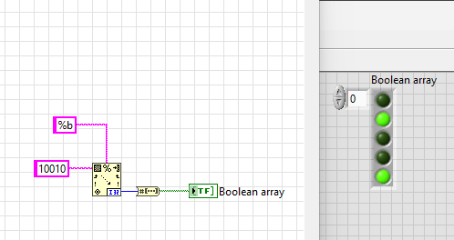

First off I recommend you watch this video: VIWeek 2020/Proper way to communicate over serial
Second I would rethink your approach as you are going to have to parse all that text in LabVIEW to determine the button status.
Unless the serial data must be "human readable" I would just send a 1 or 0 for each button.
10010 would be sw1 closed, sw2 open, sw3 open, sw4 closed, sw5 open.
That would be simple to parse in LabVIEW.
EDIT: forget the commas, look how easy it is to parse this string...
