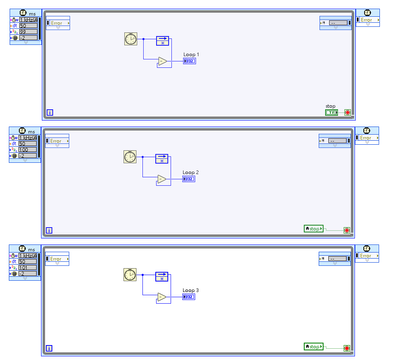

I created a simple vi to see the loop times by using the default setting of the "time loop".

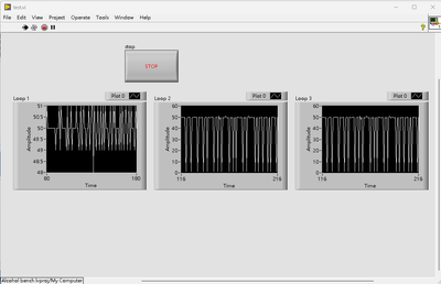

If I run in the vi state, these loop times are very stable around 50ms +- 1,2 ms.

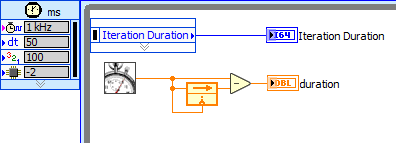

  • What does the "iteration duration" data node say? (picture)
  • why don't you use the high resolution relative seconds to avoid the quantization to whole milliseconds? (picture)

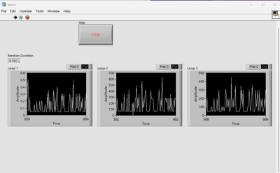

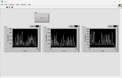

Due to the developed program, I find the compiled file on win10 21H2 is well done, and the loop time will stay around 50ms. But after I upgraded the PC sys to win10 22H2 and win11 22H2, the loop time of compiled .exe files will be unstable around 50~400 ms. So, I try to use the simple 3 loops to see what happened.
PC HW: i5-8265U, 16GB ram
However, I took the developed program (.exe) to another PC(win10 22H2, labview 2013 installed, 2015 2017 2018 2019 2020 sp1 run-time installed),
in the beginning, the test .exe file can stay around 50ms, after I closed and re-run the same .exe. file,
the same unstable result would be saw again.
    • iteration duration 0~3.7, shown as below.
    • I just try it. The same result as using tick count.

I found the problem after I upgraded win10 21H2 to win10 22H2.
The loop-time of the .exe test file stays unstable in 50 ~ 400ms.
However, I tried to remove and install LV2020 and Run-time engines (19sp1 ~ 22Q3 f1).
This issue can still be there.
So, I upgraded win10 22H2 to win11 22H2. The result is still bad.
Only, the loop-time of test .vi file can be stable in 49~51ms. (no matter in win10 22H2 or win11 22H2)
