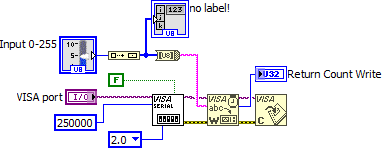

Sorry - attached is a VI and a screenshot of MAX.
I want to be able to send the machine numbers between 0 and 255, with the settings 250k baud rate, 8 data bits, no parity, 2 stop bits, no flow control.
Thanks!

Hi lol,
why are there so many coercion dots in your VI? Why are there indicators without a label?
Like this?
Usually you don't close a (serial) port immediatly like you do in your VI…
Basic stuff (to be learned by taking the free training courses): create constants by right-clicking inputs of subVIs/functions!

Here is my updated VI. I am just confused why you removed the start bit?
 Thanks for your help.

 Hi lol,
I removed that Rube-Goldberg array handling in your code because I didn't know what you are trying to do here. You didn't mention any "start bit" before…
(When you want to send more than one byte then just pre-/append more U8 values using this BuildArray node!)
