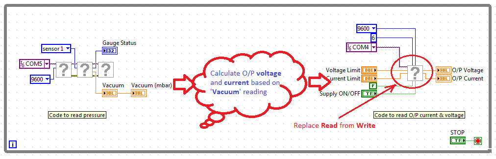

Unfortunately I don't have drivers for either of 'Pfeiffer vacuum gauge controller' and 'TDK lambda power supply'...!!
But went through your code, and it looks like you're reading from both the instruments... but you should be reading only from 'Pfeiffer vacuum gauge controller' and should be writing (current or voltage or both values) to 'TDK lambda power supply'...!!
Now before you write the new (current or voltage or both) value(s)... you can place a simple algorithm that will calculate new value (based on reading from 'Pfeiffer vacuum gauge controller')....!!
