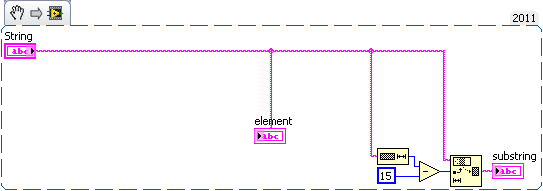

Hi Nghtcrwlr,
below i am attaching the code to remove the last element, it does not depend upon the length of th stirng, you can try this if it works for you.

@ Nobert: Yes . the string format is always the same. with semicolon as seperators.
@ Cameron: using $ character was quite a new info for me. thanks for the tip. But what if I dont know the last element before searching? Then using a token is not possible, rright?
@ others: thanksyou very much for the help. all answers are working.Thanks
