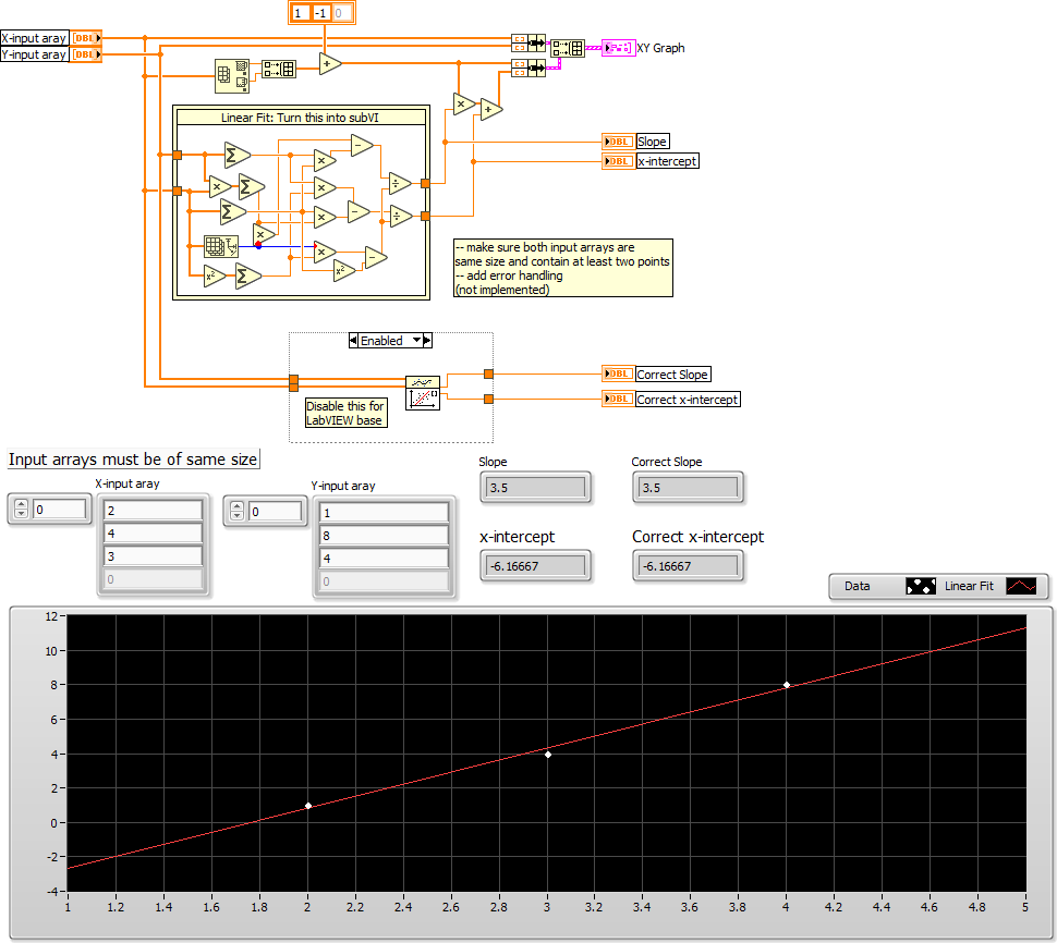

Accepted by topic author Ken_Brooks
@cstorey wrote:
It was simply used as rough estimate
Your slope is good but the offset is way off. Not sure where the error is, but compare with the stock linear fit.
For fun, I implemented the correct formulas in g (probably similar to what bob suggested earlier) and it gives the correct result. As seen from the diagram comment, things need to be cleaned up and error handling and input validation added.
The stock VI has outputs for error and best Ys and also has inputs for weight, tolerance, bounds, etc. So this is not a replacement. (edit: uploaded new version with correct intercept labeling)
Message 5 of 10
(7,340 Views)
Thanks, cstorey and altenbach combined, you probably saved me a couple of hours of comprehending and coding that math.  You're stars!  cstorey, I'm curious, why did you produce the X intercept instead of the customary Y intercept?
And I note, even Altenbach's version does not produce an intercept number consistent with what is displayed on the graph (and the graph looks to be the better of the two!)  The stated intercept with the given data is -6.16667 but the visual intercept is about 1.75!
Message 6 of 10
(7,291 Views)
I think he just mislabeled it.  The value corresponds to where the Y-intercept would be.
Message 7 of 10
(7,287 Views)
Be careful what you write! It is not often that CA is wrong. (He is not wrong here) Look at the graph, the y-intercept (offset) gives the value when x is 0, on the plot x does not go to zero, it stops at 1. Replot the graph and change the lower limit to 0 and see what you get.
mcduff
Message 8 of 10
(7,263 Views)
I was interested in extracting slope and theshold current (Ith) which is the X-intercept in a V vs. I curve.  I used these values to assess where the laser I was testing was in fact "lasing" or just producing spontaneous emission.  If it was lasing then I carried on with the excruciatingly long slow test, it it wasn't "lasing" after a certain threshold then I abandoned that device and moved on.
Yeah, I didn't return the Y-int.  Sorry, I should have caught that and made it obvious.  But CA's full LabVIEW version is a much more elegant solution, as per usual!
Craig
Message 9 of 10
(7,259 Views)
Yes, the returned value the Y intercept (where x=0)
(did not notice and just re-used the original label :). I uploaded a corrected version, just calling it "intercept" like the stock VI output. picture is still wrong...)
