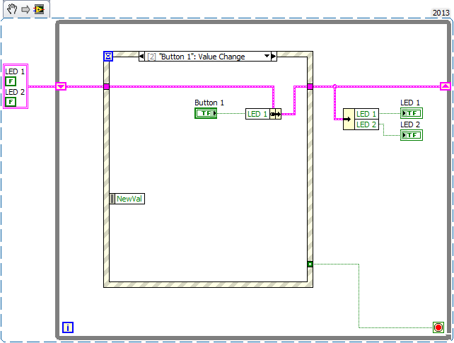

A common solution to your situation is to save state information on a shift register of the loop and update indicators from that.  For example:

Each event case can handle multiple events.  You could put both the On-button value change and Off-button value change events in the same event case.
