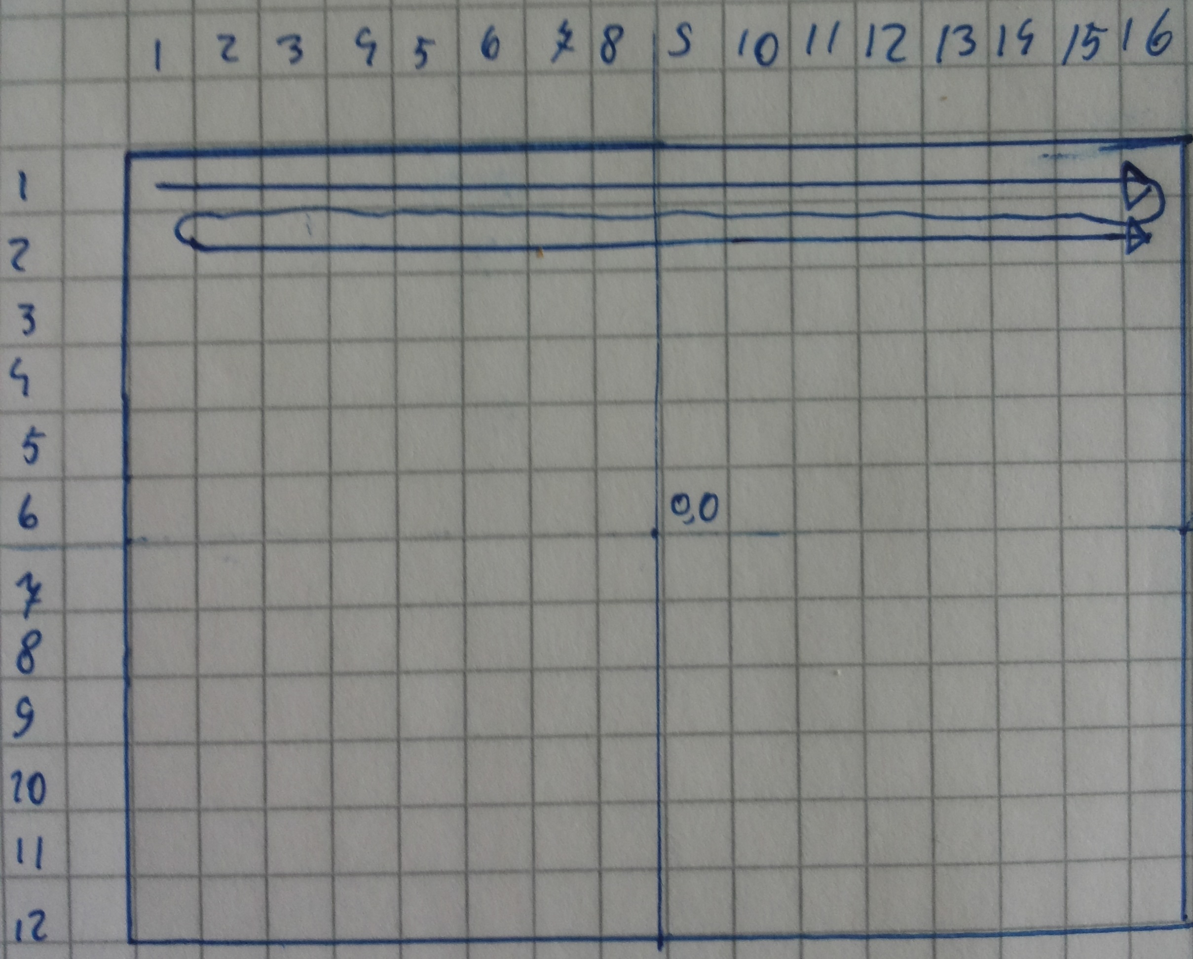

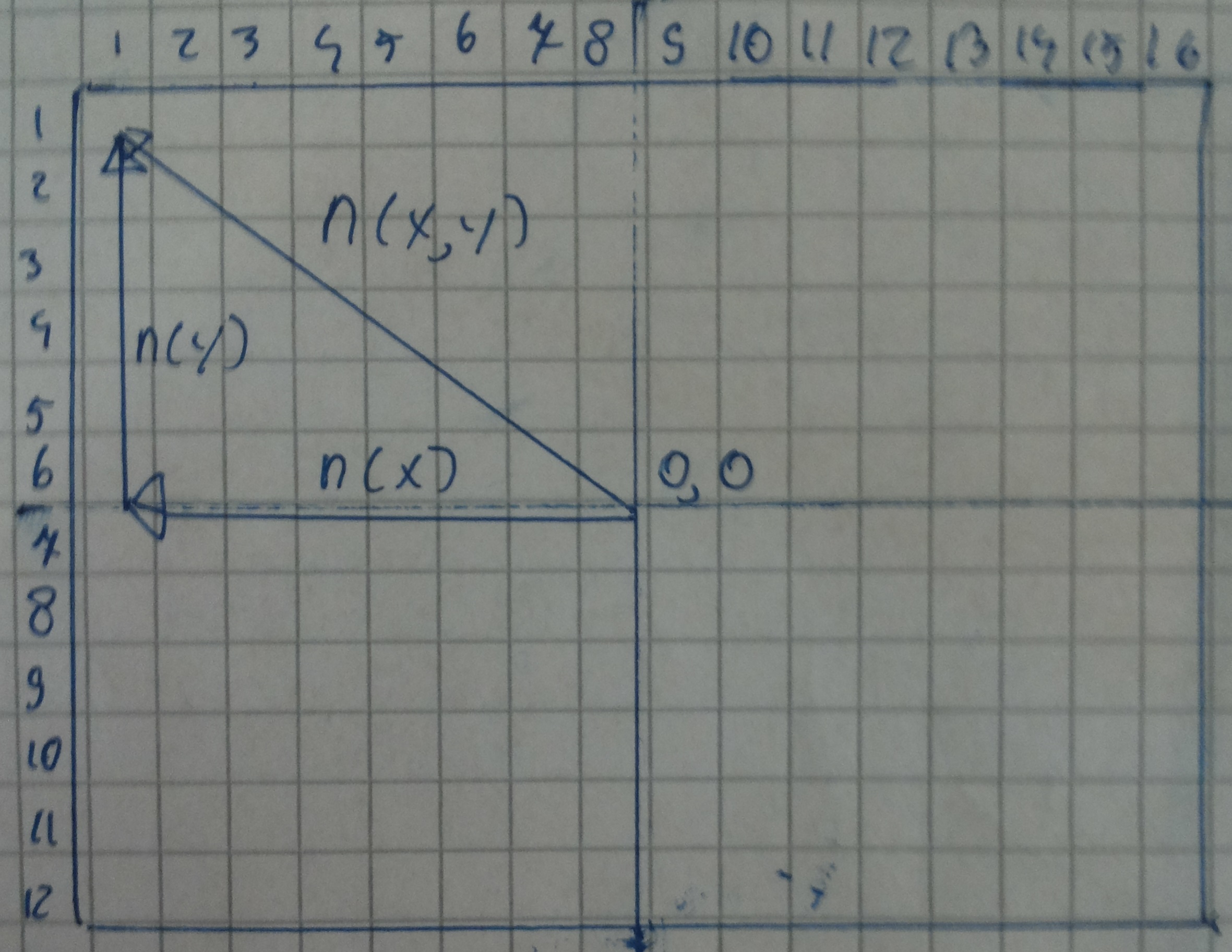

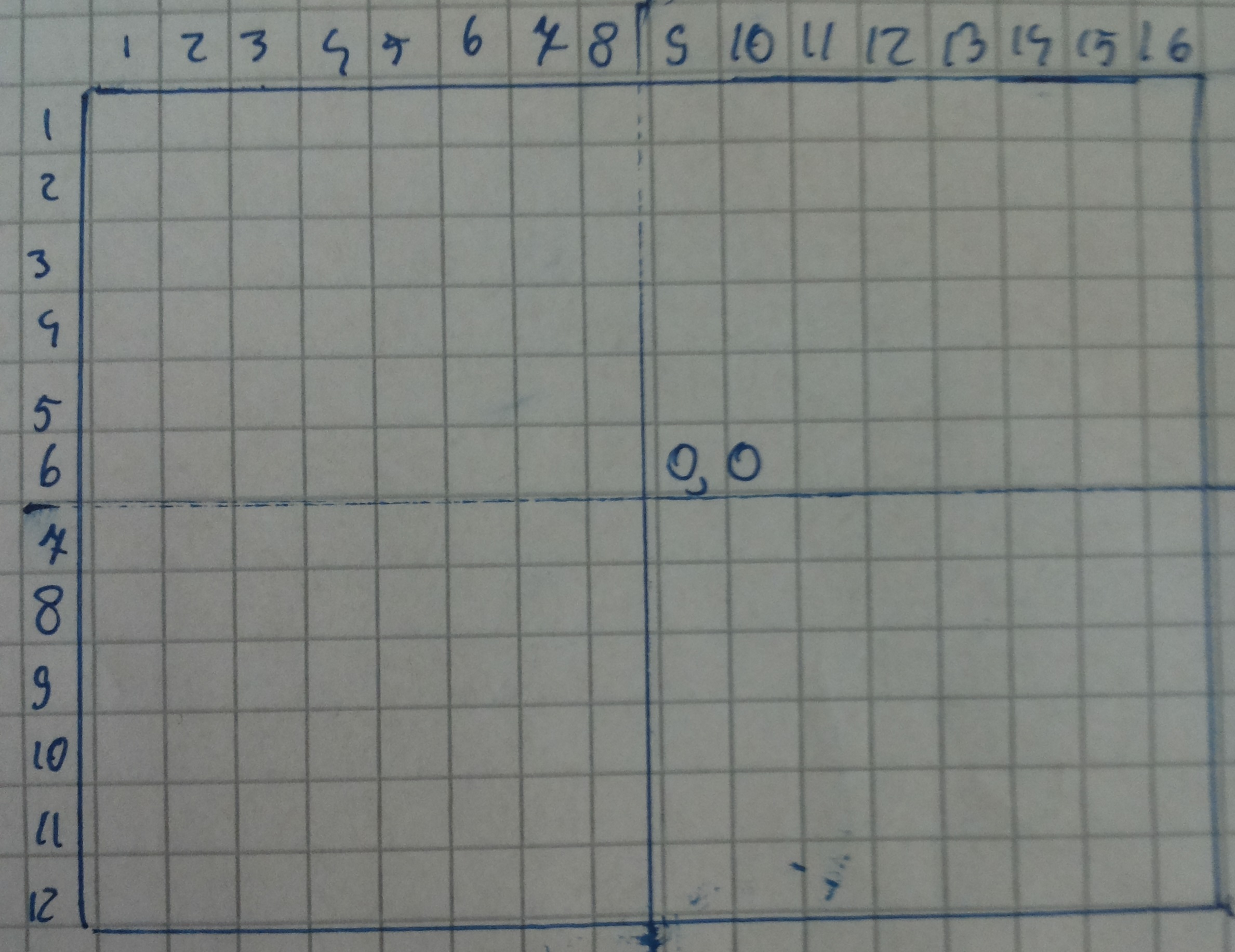

 To illustrate, imagine an image of 12 X 16 pixels:

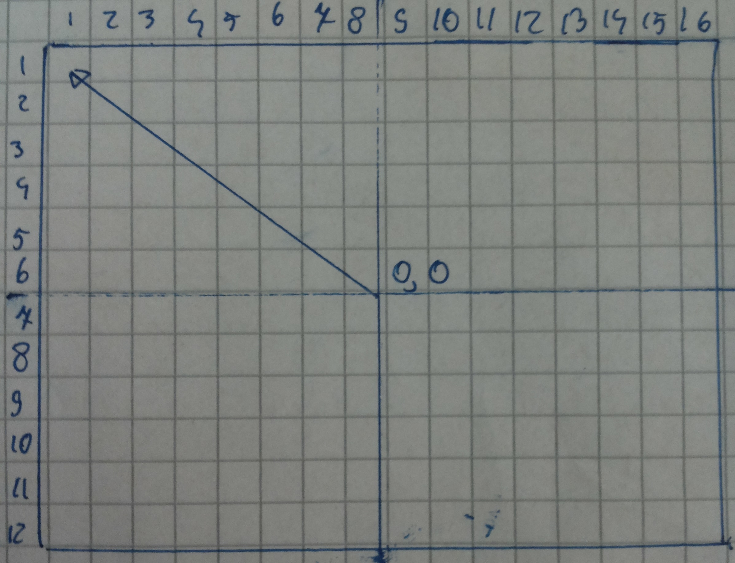

I want to calculate what value each pixel is supposed to have. I do this by comparing the actual value with the value I want. I calculate the value it needs to be at a certain pixel by looking at how far it is from the origin. The origin is in the center:
The distance then from the origin to the actual pixel is this:
The length of this 'vector' is then calculated by splitting it into a horizontal and vertical part:
The length is then the the x-coordinate squared and the y-coordinate squared added together and then the root of that number is taken. So that's basically the theorem of Pythagoras. I know that in this case, the length found is not the real length, because you use x=1 and y=1. So first off I subtract 8.5 from the x value and 6.5 from the y-value before going any further.
But I want to process the pixels in the order of y=1 x = 1, 2, 3, 4, 5, 6, 7, 8 etcetera and then y=2 x=1, 2, 3, 4, 5, 6, 7 etcetera. That is exactly what lexicographical processing is. But how can I get this to work? In my VI you can see how I am currently exporting just the numbers of the total size of the image (or frame of a video), but I want to process them one by one. I looked up some helpful Labview files that do something similar, like the 'Check Pixel Value' VI but there you have to manually scroll through the data. I want it to happen automatically.
So how can I process pixels of an image lexicographically?

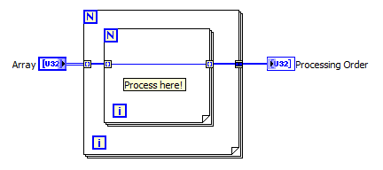

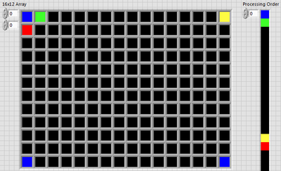

Forgive me if I'm missing the obvious, but I read and re-read your post a few times and is the solution not as simple as:
When you have a 2D array and you have a nested for loop with indexing, it will iterate through the 2D array in left to right reading order. You can then either re-index the items to build another 2D array of calculated values or do what I've done and concatenate the second terminal to put the items into a 1D array.
I can't see your VIs as I don't have LV2013 but I'm assuming you have a 2D array of something and you want to process each item in lexigraphic order?

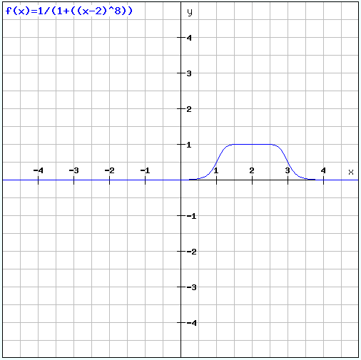

We look at the profile and compare that to a profile as simulted by a Super Lorentzian function
A Super Lorentzian function looks like this:
A / (B + ( (X-C)/X0) ^n)) + D
A/B is the top value
C is the horizontal transliteration
X0 is a value referring to the width of the function
n is a power
D is vertical transliteration
For even numbers of n the function produces a top hat function. In our case, we want to simulate an eigth order Super Lorentzian, so n=8

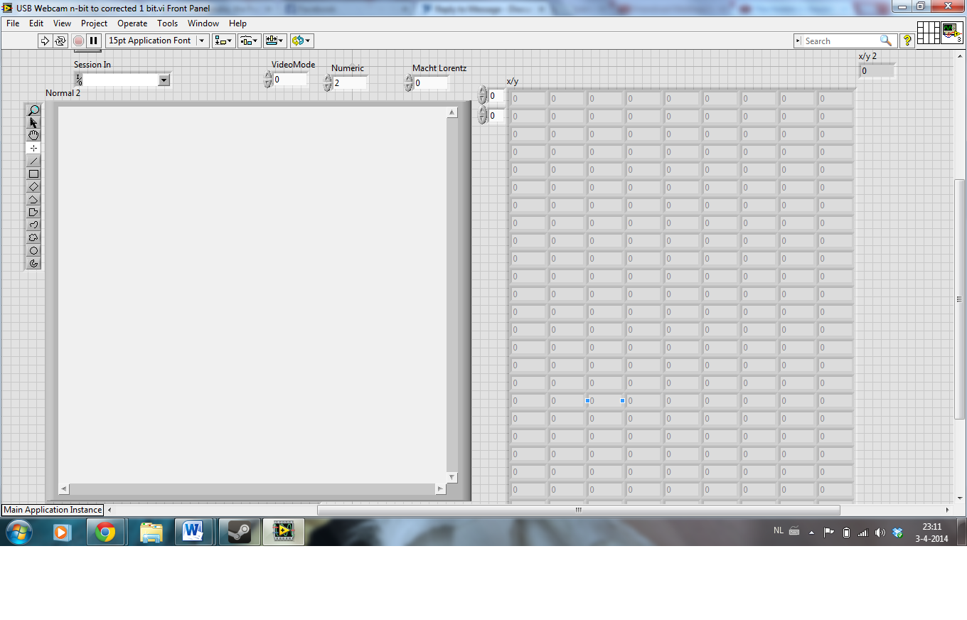

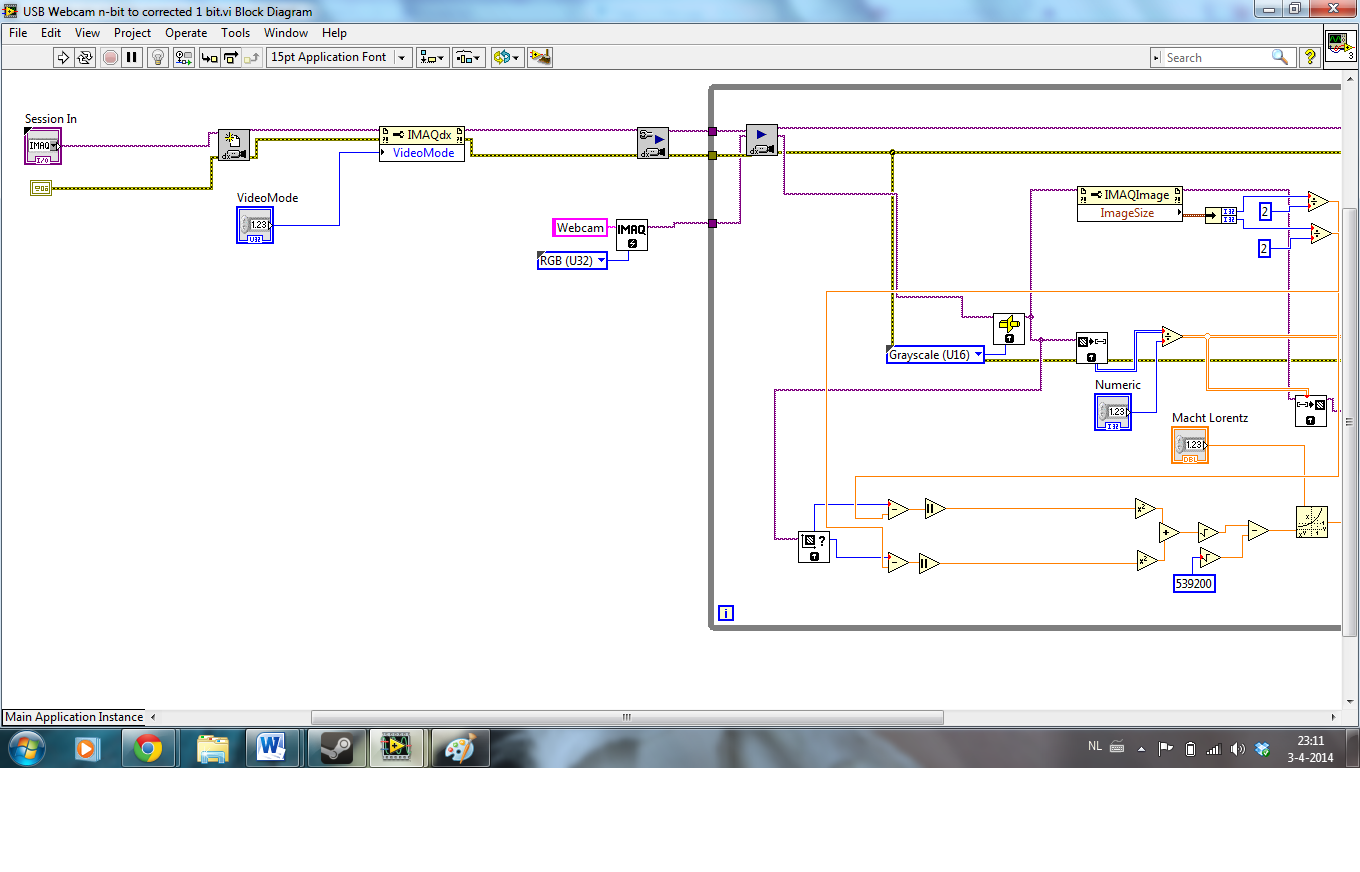

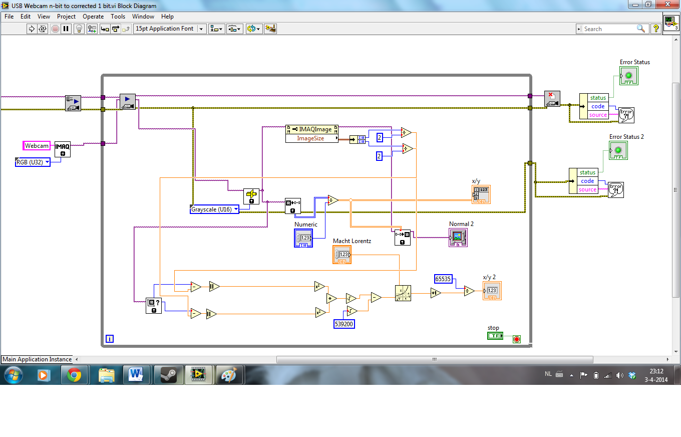

Here a some screenshots of my program so far:

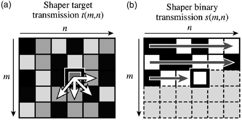

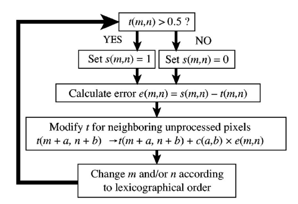

Our error inducement comes from an algorith developed by Dorrer and Zuegel, two german physicists.
A screenshot of their paper concerning binary spatial light modulation:
But the main issue I am concerned with is thus the error inducing. Doesn't normal array processing remove the possibility to do so? And if not, how can I do it?

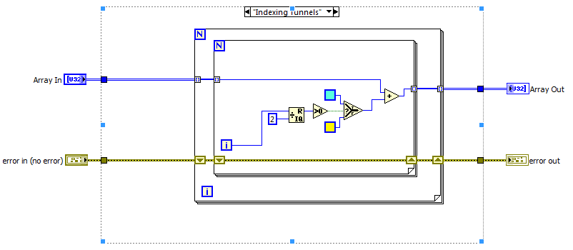

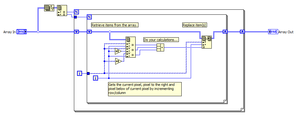

When you talk about error inducing, are you talking about LabVIEW error? You'll need to decide how to handle those - either by ignoring them or stopping the execution.
If you need to do further array manipulation, you can use functions in the Arrays palette like "array subset" and "replace array element" - this would allow you to pull out the surrounding elements from the array as well by incrementing/decrementing the row/column index. You'll of course need to check for edge conditions (when there is no surrounding pixel).
I've attached an example (in LV2012) that shows how you could wire the errors through the for loops and a couple of methods of manipulating items in an array. (For performance reasons, you could replace the index array / replace array subset with an in-place structure).
Screenshots from VI:
(blog)

What I meant with error inducing is this:
We use a Digital Micromirror Device. That is a type of Spatial Light Modulator that has tiny mirrors, all of which can be either 'on' or 'off'. So it's a Binary spatial light modulator.
What we do is we calculate what value it is supposed to have and what value it currently it has.
In the picture, this is determined by the reflection of the pixel (or in reality, the mirror). This reflection function is known as  t(m,n).
However, since the mirrors can be either on or off, we must make a decision based on this. Is the reflection more than 0.5? Than we turn it on. Is it equal or less? Than we turn it off.
This actual value that we give to the mirror (on or off, 1 or 0), is what we send to the DMD and is called s(m,n)
But you can probably see that this is not really the right way to go. We need (for an example) a reflection of 0.6 for a certain pixel, not 1.0. This means we are a bit off of the true value the mirror is supposed to have. That amount we are 'off' is an error. We must make up for this by considering the error of one pixel when we are calculating the next one.
This is done by adding to the normal algorithm for calculating the value the error of the previous pixel(s). The error, e(m,n), is calculated by the difference between the actual value s(m,n) and the value it is supposed to have, t(m,n).
This process is shown here:
The constant C is determines on which pixel relative to the original you are calculating the error for.

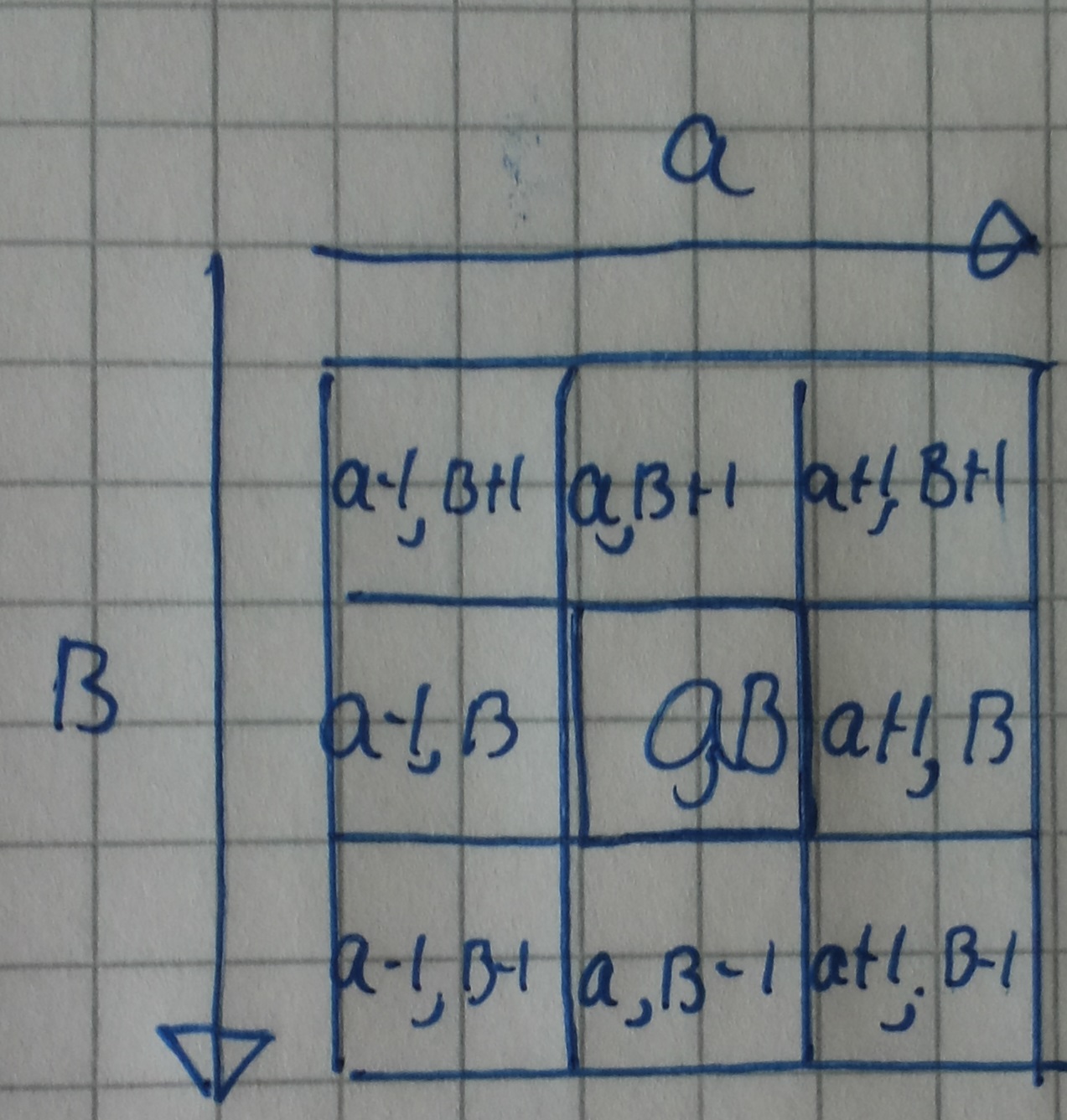

To show: normal processing does:2014-04-04 11.42.23.jpg
But the control I want is shown here:
I need to be able to control these neighbouring pixels too. To be more specific, I need to control a-1,b-1 & a,b-1 & a+1,b-1 and a+1, b.
This is also shown here, in this screenshot of a paper of Dorrer and Zuegel:
The arrows represent which pixels we want to use to solve the error that was induced by rounding to 0 or 1.
Doesn't this 'loop in a loop with indexing' remove the possibility to give the error function to these pixels? Because that information is then outside of the loop, not inside.

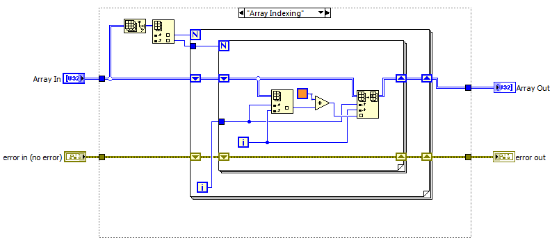

Ok - this is quite difficult for me because I know nothing about what you're trying to do (in terms of your application), but I know I can help with the actual LabVIEW so to help me to help you, try to pinpoint exactly what it is you are struggling to do in LabVIEW.
From what I understand you want to iterate through all of the pixels, but to do calculations based on the pixels around the current pixel.
You can do that by indexing as many items as you want from out of the array and adjusting the row/column indexes accordingly. I've attached an updated VI that demonstrates this.

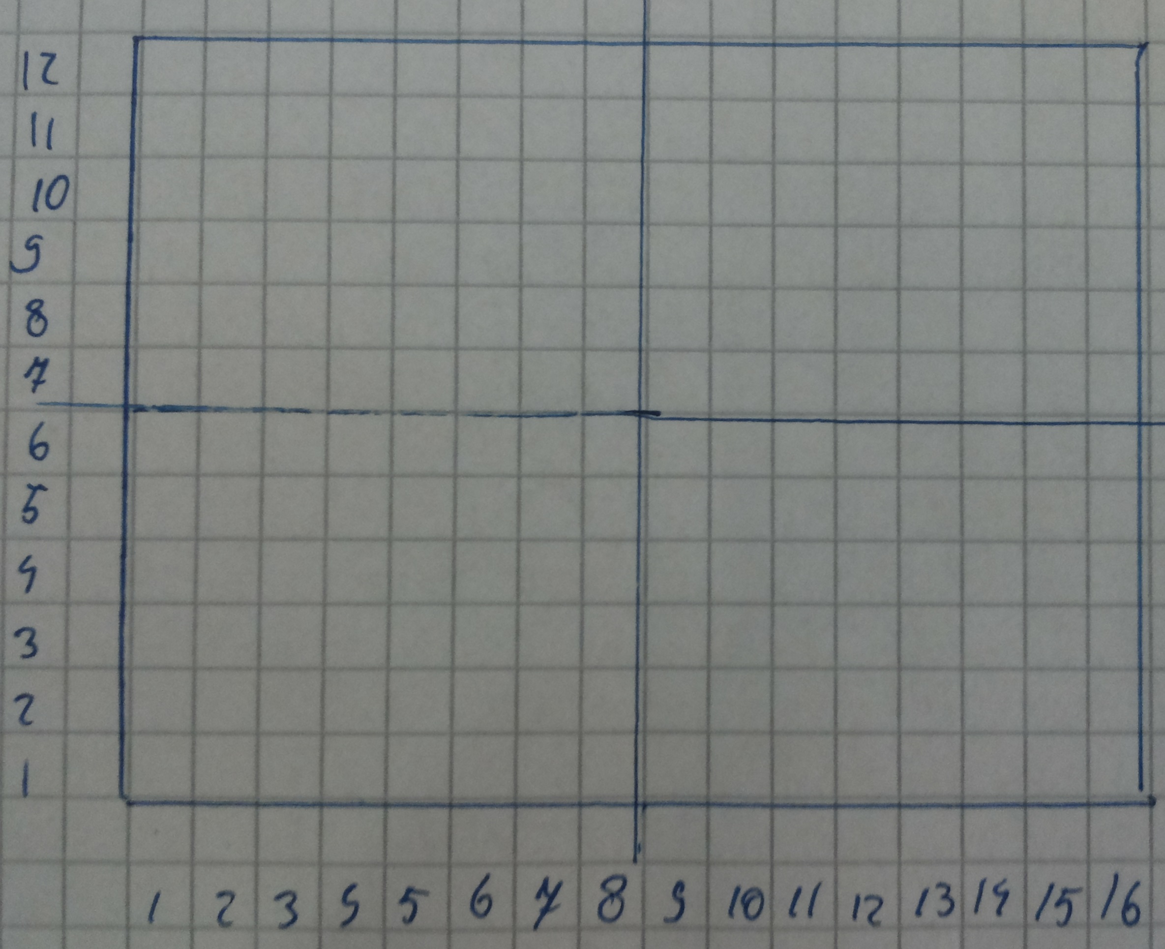

As shown in my beautiful drawings, I want to calculate the distance of the pixels, ofcourse in lexicographical order. Since you have shown me that the standard way for Labview to process arrays is lexicographically (and I must add I am very grateful for the insight you have given me) that is no longer an issue.
For the 'distance to center' calculation, I want to try the following:
Since I know it's going to calculate from left to right and starting in the top left corner and I know the resolution it will need, why not use that information to 'count down' from the resolution?
By that I mean the following:
I know the resolution 1024 x 768. That means the center is at 1024 / 2 =512. However, since it's an even number, there is no absolute center pixel. So the actual middle (or median) is at 512,5.
Same goes for 768: 768 / 2 = 384, median is at 384,5.
The center of the image is at 512,5 x 384,5. If you do not agree with calculation to find the middle of the image, then by all means please say so, for I myself cannot remove doubt from my mind even though I have the proof of it laid down before me in the form of a drawing.
But then the pixel at the top left corner is then at a distance of:
square root of (512,5² + 384,5²) = root of 410496.5 = 640.7000078. I then use that for my formula to calculate what value it should be (the superlorentzian formula). These coordinates will then also ofcourse work for the bottom right, bottem left and top right of the image, since these are at a distance that is the same size.
Then I perform the same calculation but then I take pixel next to it: it will be at a distance of which the horizontal and vertical components are also known.
The first pixel was at a distance of 512,5 horizontal and 384,5 vertical
The second pixel was at a distance of 511,5 and 384,5 vertical
The third was at a distance of 510,5 and 384,5 vertical
The fourth pixel is at a distance of 509,5 horizontal and 384,5 vertical
Etcetera
I am thus now 'counting down' from the known coordinates from the top-left all the way until -512,5 and 384,5 vertical.
When that point (the point -512,5 x 384,5) is reached I go down one part vertical. So I then use -512,5 horizontal and 383,5 vertical. That way I calculate down from 512,5 x 384,5 (top left corner) all the way until -512 horizontal and -384,5 vertical (bottom right corner).
This however is more of a 'brute force' method. Is this the most efficient way to do this? Or can Labview give me the values themselves without me having to presume their location (which is what I am basically doing right now).
