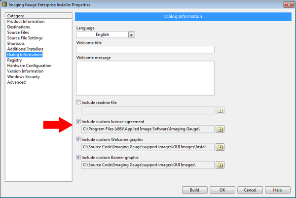

I created and installer in LabVIEW 2011 (64-bit OS with Windows 7).  I added a custom license agreement (rtf) file to my installer and included it as shown below.

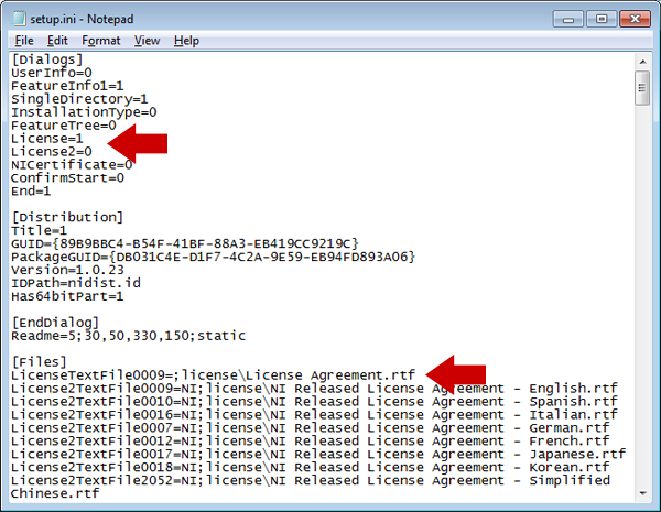

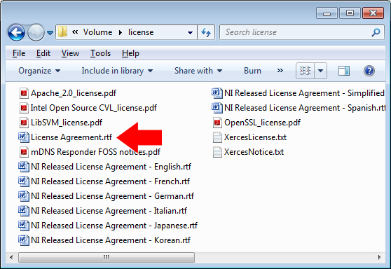

The setup.ini includes a reference to the file and I confirmed that the file exists in the License folder:
When I test the installer on my development PC or target PCs, my custom license agreement is not displayed.  I've toggled the boxes in the setup.ini to show the standard NI EULA but that doesn't get displayed either.
