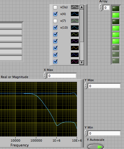

It works for me. I am using LV 2014. I happened to have a VI with a graph with the checkboxes used so I added the property nodes as a test. The values in the boolean array follow the visibility checkboxes checked exactly.
Note: The array of clusters wired to the autoindexing tunnel is the data going to the graph. This tells the for loop how many plots exist.
Lynn
