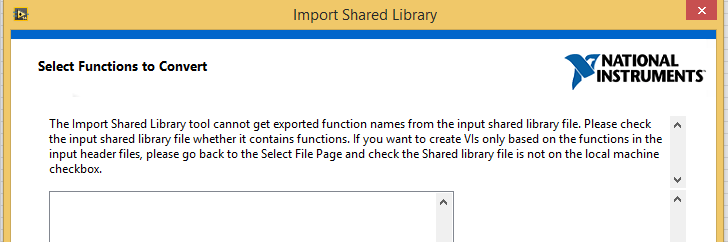

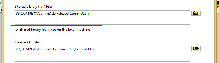

I am suffering about linking a DLL into LabVIEW. I am using LabVIEW 2014 32-bit and generating my DLL in Visual Studio Express 2013. I am using Import Library Wizard (Tools->Import->Shared Library), I select DLL file and header file, I click next, and getting error "The Import Shared Library tool cannot get exported function names ....." as pictured below.
I read lots of topics in Forum about DLL importing, but I could not solve my problem.
What am I doing wrong?
Thanks.

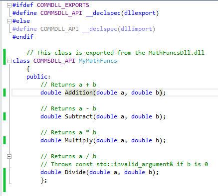

commdll.hpp

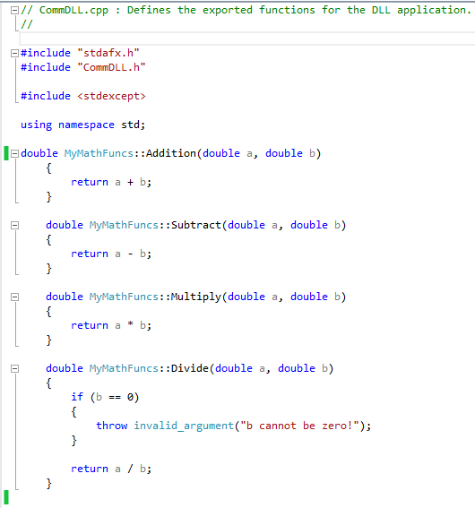

comdll.cpp

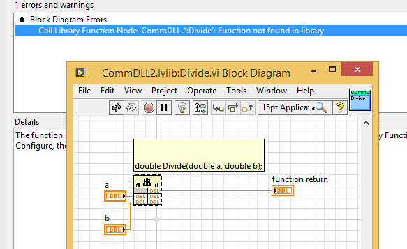

If I select I get only 3 functions, the function Addition is not listed as pictured below:
And of course it does not work.

In my experience, I have instantiated my class in global space and wrapped the object's class methods inside global space functions as shown below.  And when you build this, make sure you tell your compiler to set the BUILDING_EXAMPLE_DLL flag (i.e. CXXFLAGS   = -DBUILDING_EXAMPLE_DLL)
example_dll.h file:
#ifndef EXAMPLE_DLL_H
#define EXAMPLE_DLL_H
	#ifdef __cplusplus
	extern "C" {
	#endif
		#ifdef BUILDING_EXAMPLE_DLL
		#define EXAMPLE_DLL __declspec(dllexport)
		#else
		#define EXAMPLE_DLL __declspec(dllimport)
		#endif
		double EXAMPLE_DLL Addition(double a, double b);
	#ifdef __cplusplus
	#endif
#endif // EXAMPLE_DLL_H
example_dll.cpp
#include "example_dll.h"
#include "MyMathFuncs.h"
 * An example of shared (global) data
MyMathFuncs myMathFuncs;
double Addition(double a, double b)
	return myMathFuncs.Addition(a,b);
Message 3 of 14

LabVIEW cannot do anything with a C++ class in a DLL, including import functions contained in a class. Any function you want to call from LabVIEW must be a standard C function. You need to rewrite your DLL without classes, or wrap the classes in standard C functions.
Message 5 of 14
(12,562 Views)
Thanks, I followed that white paper, I deleted class and implemented everything as C functions, it works now.
