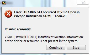

Driver Error
I have physically connected, however, this error occurred. I've downloaded the right driver and I'm using it. Please advise.
Message 15 of 19
(1,820 Views)
That's an instrument specific error. You are setting something incorrectly or there is a big in the driver. Please contact R&S since it is their code and you have not provided details on the parameters you ate passing to the driver.

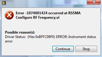

Now I'm receiving this error.

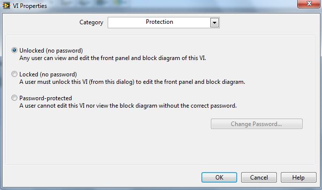

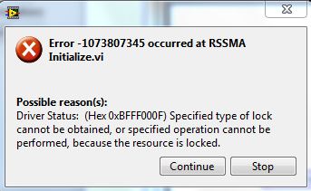

I've linked the oscilloscope to my computer, now how to I overcome this locked VI issue? Please advise. Thank you.

It's not a locked VI, it's the resource that is locked and probably by another VI.
