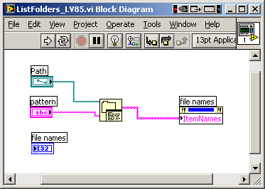

I try to filter a file list on a network drive by pattern using the List Folder VI. This worked fine in LV7.1.1.
Upgrading to LV8.5 or higher the pattern matching does not work any more.
The code I use is:
Example:
Y: is a network drive mapped with "net use" command on a windows XP machine.
DOS dir command of test folder "temp":
 Verzeichnis von Y:\temp
27.04.2013  12:33    <DIR>          .
27.04.2013  12:33    <DIR>          ..
27.04.2013  12:05                 0 Test1.dat
27.04.2013  12:05                 0 Test1.txt
27.04.2013  12:05                 0 Test2.dat
27.04.2013  12:05                 0 Test2.txt
               6 Datei(en)              0 Bytes
               2 Verzeichnis(se),  6.550.585.344 Bytes frei
With an empty pattern in LV7.1.1 the file names array contains all files:
Test1.dat
Test1.txt
Test2.dat
Test2.txt
Test3.dat
Test3.txt
Filtering for *.dat files (pattern = "*.dat") works as exspected, file names array contains:
Test1.dat
Test2.dat
All good with LV7.1.1 ! (don't worry about the file size of 0, I just created some demo files - same with other files).
The same code used in LV8.5, 8.6, 2010 works also if pattern is empty. But the file names array is empty when using the same pattern *.dat as before.
It works if a local drive or an USB attached drive is used, but not on a network share.
I found something similar in the posts about problems when using some more or less special characters in filenames on a network drive, but here no special chars have been used. I consider this to be a LV problem, as it worked in LV7.1.1.

Is it possible to attache your VI or at least a screenshot of your VI to your next post?
This would be very useful!
Message 2 of 8
(4,189 Views)
Sorry, I added a picture below the "The code I use is:" line but the board deleted it. (Now I know that one has to use the insert image function instead of copy & paste Smiley Happy).
The code is quite simple, just the list folder VI from the palette and minimum controls..
I'll attach a zip with the demo test files, the VIs and some screenshots.
Thanks.

Both VI seem to work pefectly with LabVIEW 2012 and 2011.
I really can't tell you why this problem appears.
The only difference I could find in your sceenshots was the fact that you were using capital and smaller letters in the path control. But this shouldn not be the problem
Honestly, I don't think that it is a bug due to the fact that it won't work in LabVIEW 2010 either.
I will install LabVIEW 8.5 to see if I can trigger your problem there.

Works perfectly fine with LabVIEW 8.5!
Your LabVIEW insallation may be corrupt.
I'm going to send you a pm with a clean reinstall tutorial.

The possibly most important information about this is not there. What server filesystem is the mapping from? If it is a Windows server, which version of Windows and which fileformat on the server and if it is a Unix server, what Samba version (or other network file sharing software) is used and what filesystem?

Thank you for dealing with my problem.
I'm a little bit stunned at the moment because today it works with all LV versions (7.11, 8.5., 8.6, 2010) on my machine; but I'm not connected to my home network this week.
I would not like to do a complete clean re-install at the moment because that may take at least 1 day to complete (multiple LV versions, different DAQ-MX and traditional drivers and some extra packages).
I'll test again next week if it's an issue related to my home network and reply again.
rolfk asked about what server:
The first time I recognized the problem was with a network connection to an ICY-Box external disk (Samba).
Then I tried to repeat the problem with a mapped drive on a WIN7 machine in the same network. Same problem.
Also same problem with a VPN connection to a windows server2003 share.
Today I checked in an other office with a WIN7 machine and also with the windows server 2003 connection -it works.
So I have to check again when I'm back at home.
Thank you so far, I'll give an update next week.
