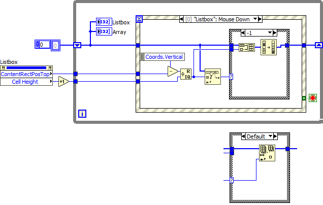

Turn it into an indicator (or disabled control, but that requires local variable to write back).
Now just use mouse-down events and toggle the moused cell. Here's a quick example.
(2,988 Views)
Accepted by topic author arob

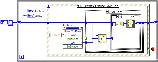

Note that there is also a "point to row" method that translates mouse coordinates to listbox rows. Useful because it can do bounds checking, ignoring clicks on e.g. the scrollbar.
