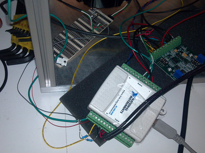

Small voltage of the load cell into the noninverting input, feedback resistors to get you a decent gain (0-5 or so), output of the opamp into the analog input of the 6008.  All I'm doing is amplifying the small signal from the load cell to a big signal (with healthy output impedance) into the DAQ.

 Snowmule,  I think I understand your setup now.  You are exciting the load cell externally and then using an op-amp to amplify the signal.  The Bridgesensor is doing these two functions for me.
