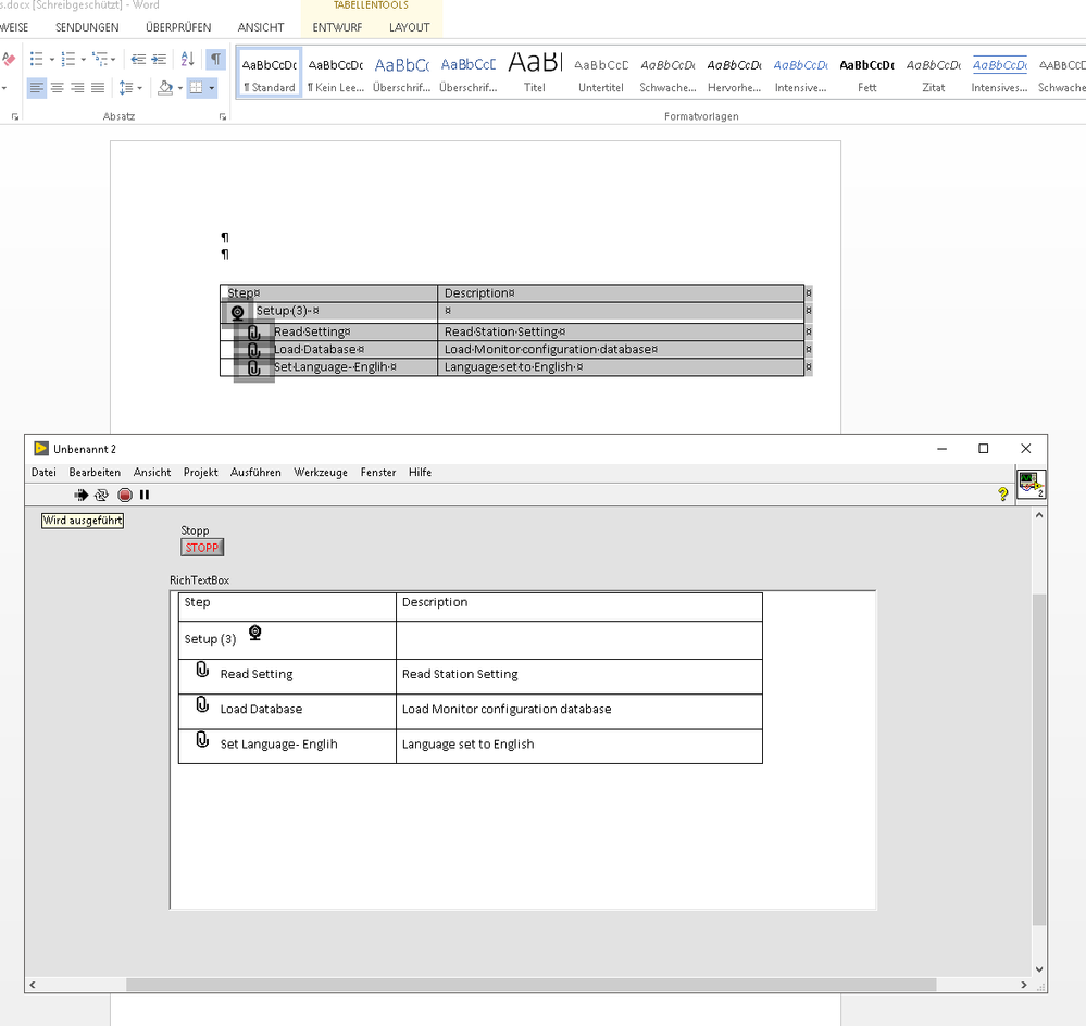

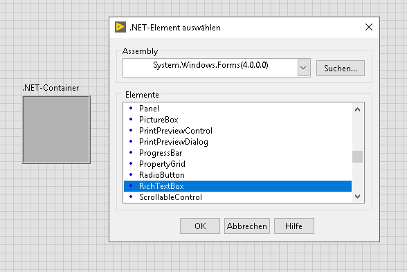

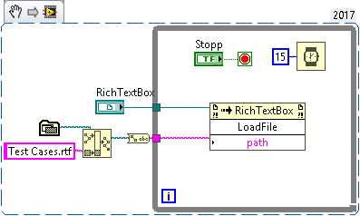

There exits a .NET Rich Text Control
If you spawn one on the Frontpanel, you can copy&paste the word documents content via  strg+a, strg+c and strg+v
I suppose, this can be done programmatically, if the word document was saved as a .rtf
most of the formatting will be preserved:
Alex

@alexderjuengere wrote: suppose, this can be done programmatically, if the word document was saved as a .rtf
