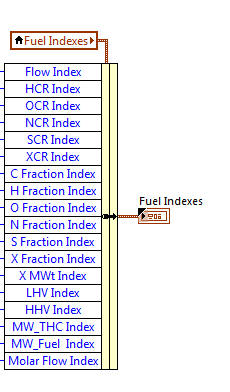

When making a VI that originates a TYPEDEF'ed cluster, I have always used a local variable of that output cluster, and a BUNDLE BY NAME function to insert the various pieces.
Like this:
Now, when I try to INLINE the VI that does this, I get an error message: "This object is not allowed in a VI on which you enable inlining".

You are exactly right about the UI Thread being the cause of not being able to inline a local.  inlined code must execute in the callers execution system so no UI thread calls are permited.
In terms of performance the local will cause a data copy the constant might meet the "magic pattern" criterea for the compiler and reuse the same buffer in later versions of LabVIEW.  I would tend to use the constant.

I think I have an explanation. When you inline, all the input and output terminals are replaced by wires. Since the indicator isn't there any more, you can't have a local variable for it.

 the exact why is not explained
I believe the "why" IS explained. This all makes sense to me now.
There can be no instance of the control/indicator, because it's never been placed on the caller's panel.
If it existed, it would have to have properties like POSITION and BOUNDS, and those have never been set.
They COULD NOT be set, since they would have to be set (differently) for each instance of the inlined VI.
The INLINEd VI requires REENTRANCY, that means there is a separate dataspace for each instance.
I suppose that dataspace now would come from the caller.
The point of the INLINE is to connect the caller's output wire to the VI's input wire AS IF the VI's code were copied into the caller.
That means that the CONTROL/INDICATOR is totally unnecessary, and can be removed.
It therefore cannot be accessed.  Not by property nodes. Not by local vars.
AND, ON A HUNCH, I tested this:  NOT BY REFERENCE.
With a REFERENCE to a control/indicator on an INLINEd VI, I get the same error: this object is not allowed in a VI on which you enabled INLINING.
Because it doesn't exist.
The control/indicator is a metaphor for the interface between the code and the screen display.  It ceases to exist when INLINEd.
