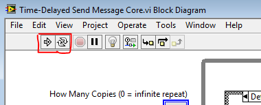

I know this is a rather late reply, but I seem to be experiencing the same thing using LV2012 SP1 (cannot currently upgrade, since the customer uses a great amount of really old NI Hardware).
I believe i tracked down the problem to the "Time-Delayed Send Message Core" which (although it should be stopping - I Call it 4 Times, it pops up 4 times and then all 4 instances close) it still looks  like it is somehow active:
Were you able to track down the problem your team had? Any info would be greatly appreciated.
Siegmund
