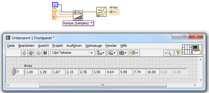

I would try this (as long as you cannot provide anymore details on your values):
Edit: Found the solution by counting more accurately:
Why you divide all array element by 10?

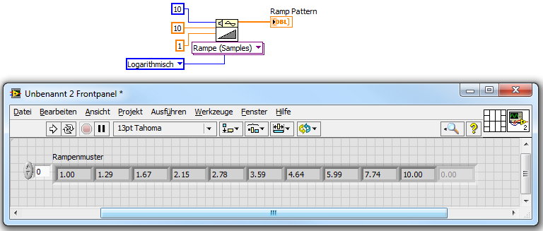

I asked for formula because in the help of "Ramp pattern.vi". there is formula for linear and logarithmic type, ramp pattern by Sample. but i am unable to find formula for ramp pattern by delta in logarithmic type. so to make sure that whatever, i am calculating is theoretically correct also.

Hi Gab,
That answer is simple: the "Delta" instance of the Ramp function does NOT support logarithmic type. So there only is a formula for linear ramps given in the help…

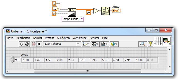

I would go this way:
With logarithmic scales you most often want either some certain values (like 1, 2, 5, 10) or "evenly spaced" on the logarithmic scale - as calculated by the Ramp function in "Samples" mode…
But thanks, now I learned about the "logarithmic" feature of the Ramp function. Never needed that before!
