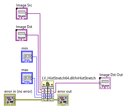

Gerd, for example, if I would like to pass native IMAQ Image Data Type into my own DLL, then I should call LV_LVDTToImage() or may be LV_LVDTToGRImage() from NIVisSvc.dll inside of my own DLL, something like that:
But this is slightly "advanced" use case. Another reason is if I would like to mix my own functions with IMAQ (like imaqGetImageInfo() etc), then I should call these directly from NIVision.dll. On the other hand its sufficient to link statically own DLL with NI DLLs, and the location is not so important, they will be called from default location. With NIVisSvc.dll its a little bit tricky, because the *.lib is not provided by NI, but it is not a big deal to generate it from DLL - this is the only one rational reason to known where NIVisSvc.dll is located.
