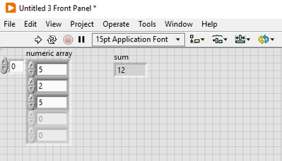

Try this below.

I was hoping to try that but I couldn't find the Add Array Elements VI anywhere.

@GRCK5000 wrote:
Try this below.
You probably missed the (FPGA) term in the subject. 😄
There is no such function, either in the FPGA numeric or in the FPGA array palette.
