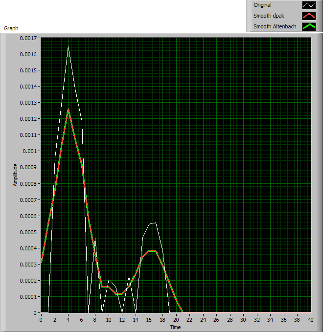

Yes, I noticed the flanking -1, +1 which are not in the formula.
Here's a quick attempt (~2-4x faster on my Ryzen, depending on half-width. It also avoids your weird wrapping, which seems undesirable. I am sure there is a lot of slack left...)
Results are quite similar, but without the wrapping around

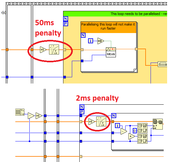

Another curious observation is the slowness of taking the "+1& ln(x)" on the 2D array. If we include that in the timing of your code, it slows down 50% (95ms -> 150ms! in your code as shown). OTOH, if we do it on each 1D array inside the parallel FOR loop, it only costs about 2ms total (42ms->44ms) in my code as shown. One reason is that inside the loop it will be parallelized, but there is probably more to that.

Hi Christian,
there's a "ln(x+1)" primitive - did you benchmark that one too?
