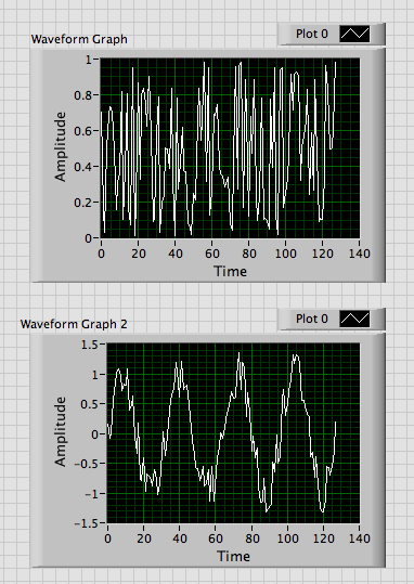

We see signals similar to these two graphs indicating that theta is not present or is present. Do alpha and beta turn on and off like that?
Although this quick simulation does not show it, the energy in the theta band during non-theta episodes is usually significantly lower. Is that what you are trying to detect?
