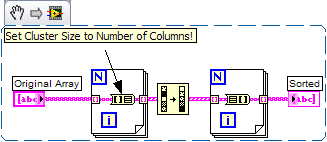

Looking at your SubVI I assume that the number of columns is fixed.  In that case, you could do something like this.

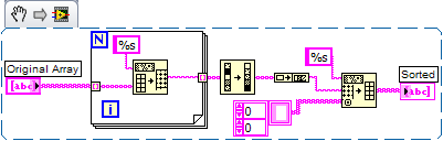

I must have had clusters on the brain, this is good for any number of columns.

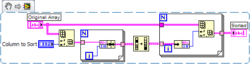

How would you implement sorting for.... per say the 5th column or 3rd column?
Message 14 of 15
(710 Views)
To sort on a different column I would typically build a cluster with that column and original index to produce a key which I then use to shuffle the array.
To do more complex sorting I'd probably go green.
